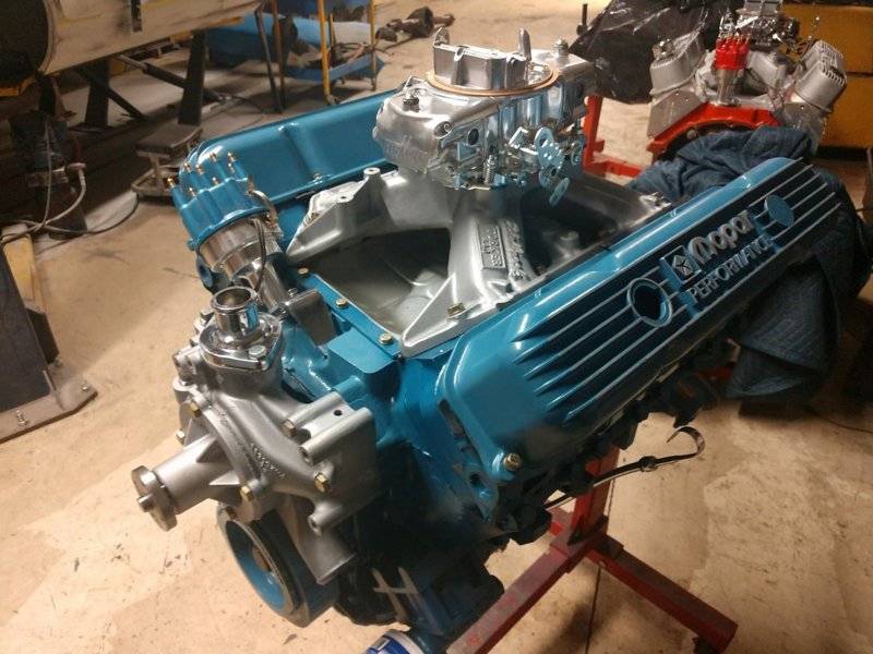

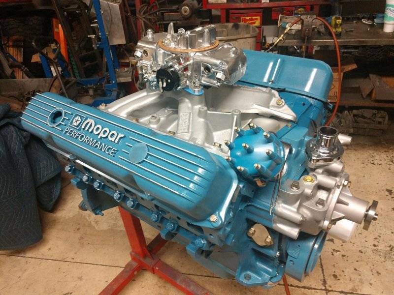

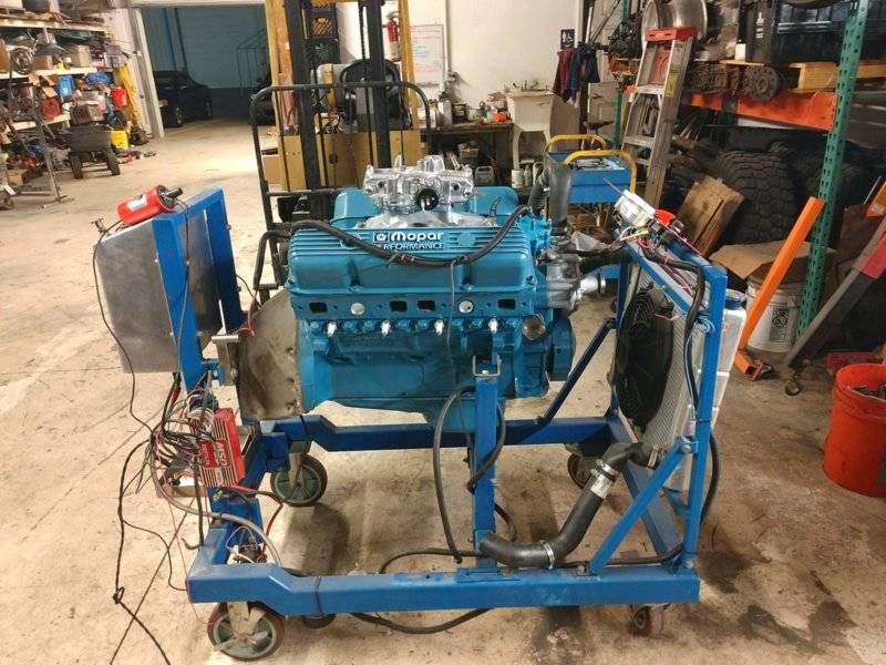

Just got this from my engine builder !! i can almost hear it and smell it !! should be picking it up by next week end !
IMG_20190228_201004765001.jpg IMG952019022195220253943001.jpg IMG952019022195220258944002 (1).jpg
Sweet. Love the OEM but performance look. I went that look also on my engine.
I typically don't like the Mopar blue. But I have to admit. Looks sharp!

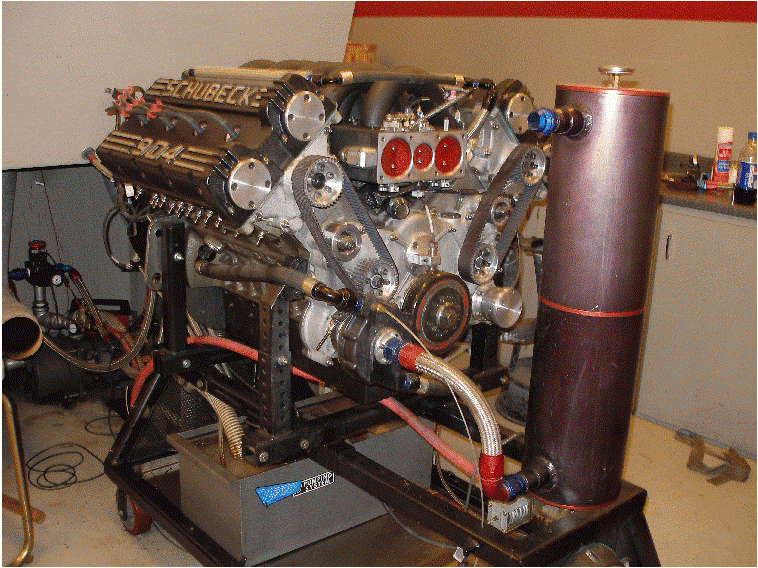

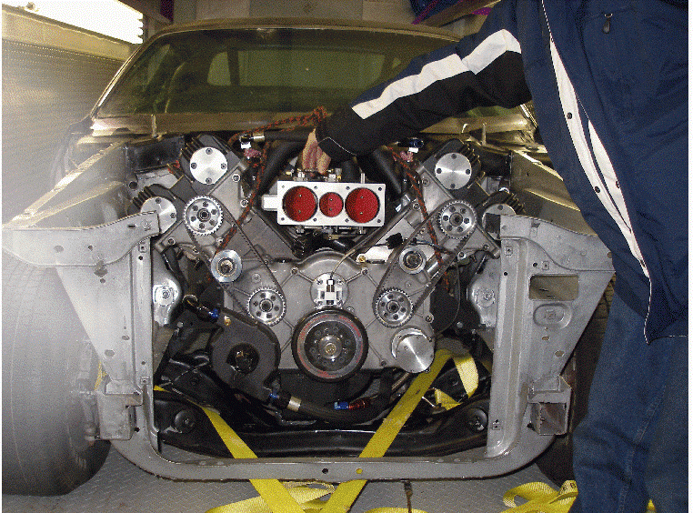

Can you elaborate what that is?? Looks like a Mammoth amount of motor.. hp?
904 ci Schubeck DOHC motor. Aluminum block and heads. 1120 HP N/A on pump 91 fuel. 10.2:1 compression. 2- 1.9" intake valves. 2- 1.5" exhaust. Dry sump oiling. EFI Big stuff management system. (LS1) It broke the the dyno before torque number. But saw meter peg at 1000 ft/lbs at about 3000 rpm. STUPID POWER.
