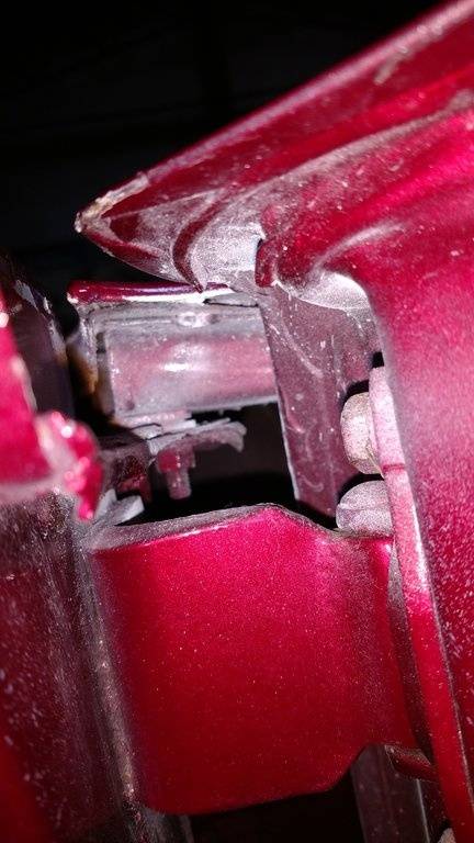

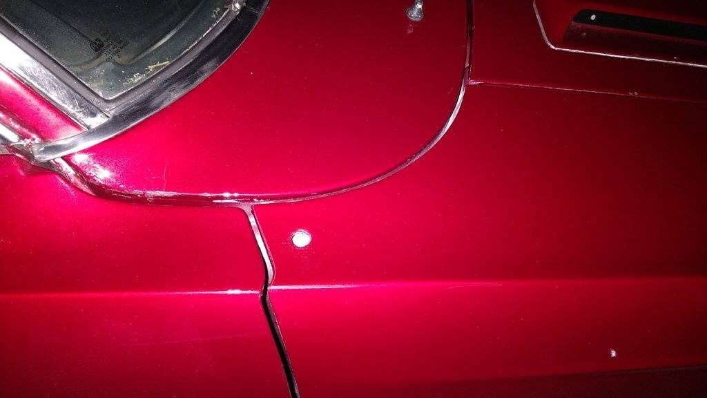

Yep, you're seeing this correctly - this fender has no evidence of ever having the normal larger antenna hole in the fender where all the others are.
Instead, it has this smaller (1/2") hole stamped (not drilled - "punched" might be the better description) out of the very corner of the fender, right in front of the door (and just forward of the hinge).

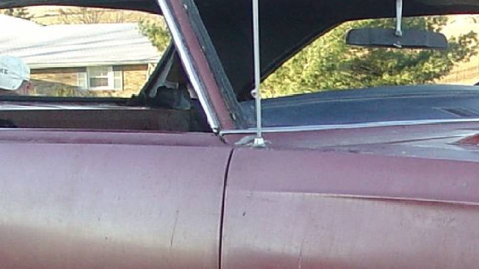

I went digging through some old pics the previous owner gave me of when the car was first brought to his shop after being plucked from a field.
This is a close-up of one such photo:
It appears that not only did the car actually have an antenna in that position in the past, but that it wasn't just one of those thin wire looking types - that's obviously a typical multi-section garden variety antenna, could even be the original one to the car, transplanted.

The antenna hole being where it is not only doesn't make sense, but the way the hole was fabricated is interesting to me as well.
It isn't drilled; instead, the edges are slightly rolled over, as if someone used a large punch of some sort (like the aforementioned Whitney punch I'm familiar with, which we used in my profession to stamp holes in building z-purlins).
It looks like a large press actually produced the hole, in other words.
