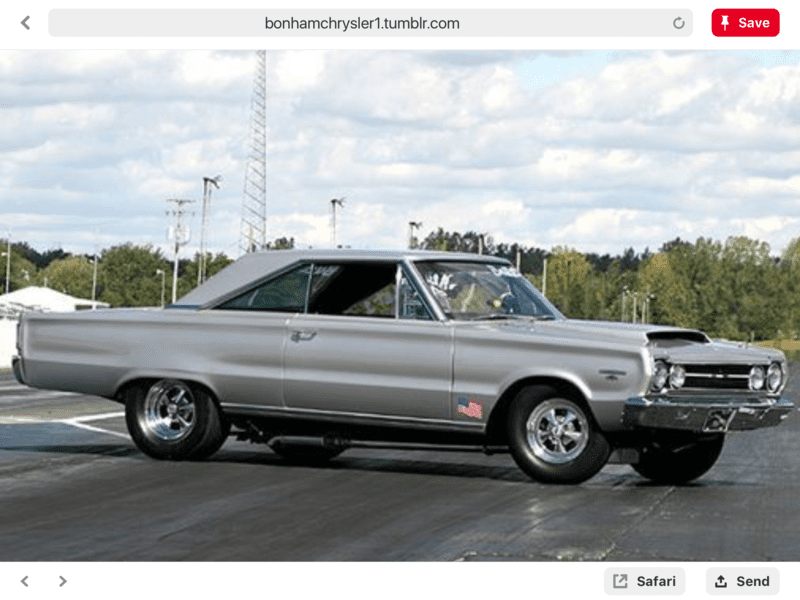

There's this,

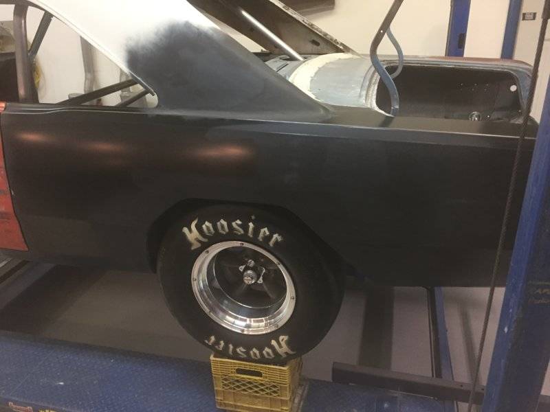

Or there's this way like I did to my Dart project.
Glassman & Malex have good idea. I don't believe that any of the old Mopars had "factory" wheel opening flairs. The '68 Hemi Dart/Cuda were just cut out quarters like Malex's picture. I rolled the quarter panel lips on my car for tire clearance.
