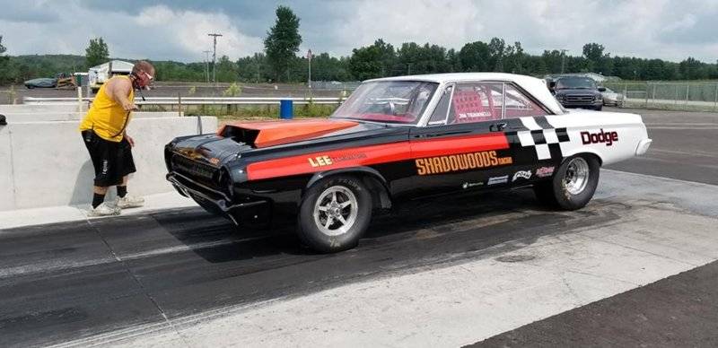

Ladder bars! Maybe that's Doug before his car was orange.
I don't know if Joe Midiles car ever went 9.20. 9.40's for sure though. Joe sold it to a local guy here, Tom Tignanelli. It's been in the 9 teens now. Looks a lot different.
Doug

View attachment 694440 I don't know if Joe Midiles car ever went 9.20. 9.40's for sure though. Joe sold it to a local guy here, Tom Tignanelli. It's been in the 9 teens now. Looks a lot different.
Doug

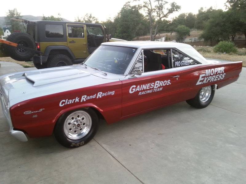

One of my best friends, Clark Rand, bought and renovated the UFO car. Clark's name is on the front fender of my current Coronet.
