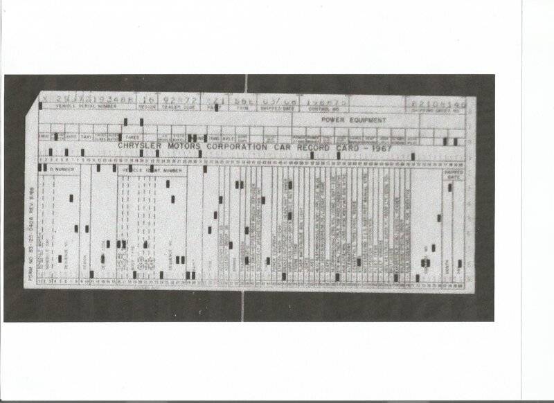

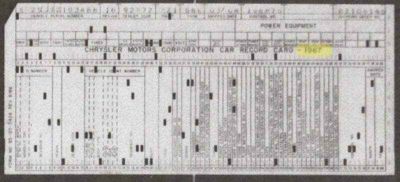

Does anyone have a source to decifer the IBM card information? After 2 years of waiting and emailing, Danielle from Historical Services came through with my card today. I would like some help to decifer the information, if anyone on the Forum has some knowledge and can look at my attached card, it would be appreciated. Thank you in advance.

I can help if its a 67. I just spent some time decoding the card for my 67 barracuda.

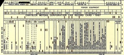

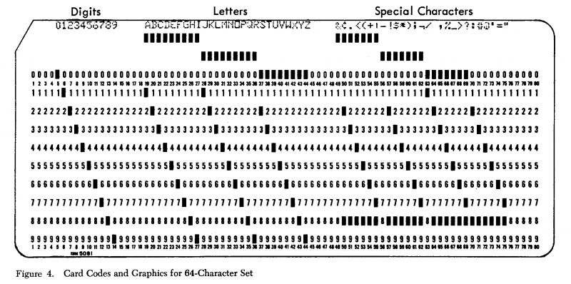

Here is character set punch decoder and a semi clear example of a card.
You have a 618 codes under stripes Im not sure of and a 689 code under export/dr demo/special that I dont know what it is.

1 to 80
Punch Hole Numbers/Letters
Combined Codes
Combined Code Decoded
1 2 R 12 2 Scheduled Shipping Month: February Scheduled Shipping Date: February 21, 1967 Shipping Order Number: 22108146
2 2 22 2 Scheduled Shipping Day: 2
3 1 31 1 Scheduled Shipping Day: 1
4 0 40 0 Sequence Number: 08146
5 8 58 8
6 1 61 1
7 4 74 4
8 6 86 6
9 1 91 1 Region: 16
10 6 106 6
11 9 119 9 Dealer Code: 92872
12 2 122 2
13 8 138 8
14 7 147 7
15 2 152 2
16 7 0 167 X Carline: X = Dodge
17 7 X 177 P Prem. Class: P = Premium
18 2 182 2 Body Type: 2 Door Sports Hardtop
19 9 199 9
20 1 X 201 J Engine Type: J = 426 2-4 bbl 8 cylinder 425hp
21 7 217 7 Year: 7 = 1967
22 2 222 2 Plant: 2 = Hamtramck, MI
23 1 231 1 Sequence Number: 193488
24 9 249 9
25 3 253 3
26 4 264 4 VIN: XP29J72193488
27 8 278 8
28 8 288 8
29 9 0 299 Z Body Paint: Gold Metallic
30 9 0 309 Z Roof Paint: Gold Metallic
31 1 1 311 1 Paint Style: Mono Tone Paint
32 2 0 322 S Trim Grade: Sport
33 6 336 6 Seat Type and Material: Bucket, Vinyl
34 5 R 345 E Trim Color: Black and Gold

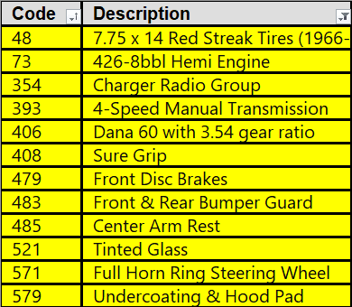

35 4 354 Basic Radio Group
36
37 7 377 7 426 2-4 bbl 8 cylinder 425hp
38 3 383 3
39 3 393 3 4-Speed Manual Floor Shift
40 6 8 406 408 Axle Ratio 3.55:1, Axle Sure Grip
41
42
43 4 434 4 7.75 x 14 Blue Streak Tires X 5
44 8 448 8
45
46
47 9 479 Front Disc Brakes
48 3 5 483 485 Front & Rear Bumper Guard Group, Center Arm Rest
49
50
51
52 1 521 Tinted Glass - All Windows
53
54
55
56
57 9 1 579 571 Undercoating & Hood Pad, Full Horn Ring Steering Wheel
58
59
60
61 8 618 Horizontal Stripe Delete
62
63
64
65
66
67
68 9 689 Special Header and Tag Instructions
69
70
71 1 711 1 Control Number: 198875
72 9 729 9
73 8 738 8
74 8 748 8
75 7 757 7
76 5 765 5
77 0 770 0 Shipped Date: March 08, 1967
78 3 783 3
79 0 790 0
80 8 808 8
