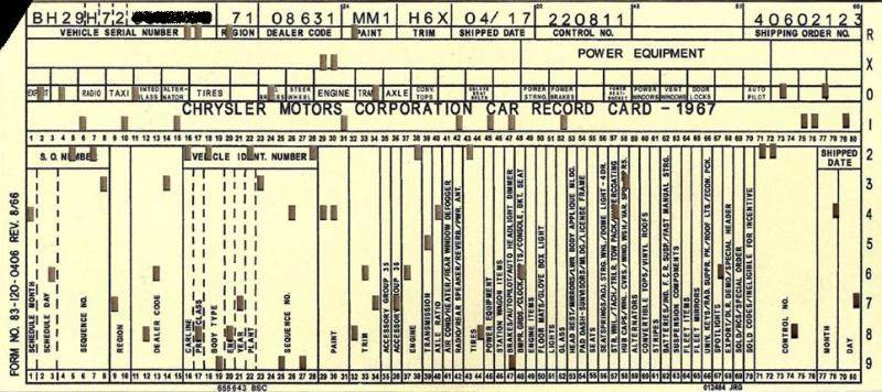

IBM Card received today from Historical Services

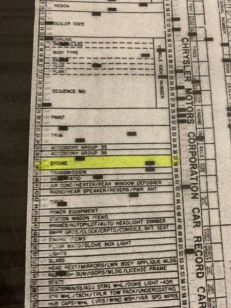

Engine is in this spot
Line numbers I put on mine, go straight across to see what number the punch out corresponds too. Mine said 073= Hemi

I have broken down my card and come up with the code numbers. Where do I find the list of codes for a 1966 to decode what I found?
I would think they’re all on line now
Here is the list I came up with to decode my 67 barracuda.

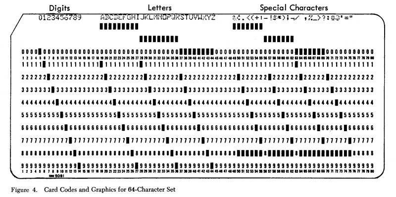

1 to 80
Punch Hole Numbers/Letters
Combined Codes
Combined Code Decoded
1 2 R 12 2 Scheduled Shipping Month: February Scheduled Shipping Date: February 21, 1967 Shipping Order Number: 22108146
2 2 22 2 Scheduled Shipping Day: 2
3 1 31 1 Scheduled Shipping Day: 1
4 0 40 0 Sequence Number: 08146
5 8 58 8
6 1 61 1
7 4 74 4
8 6 86 6
9 1 91 1 Region: 16
10 6 106 6
11 9 119 9 Dealer Code: 92872
12 2 122 2
13 8 138 8
14 7 147 7
15 2 152 2
16 7 0 167 X Carline: X = Dodge
17 7 X 177 P Prem. Class: P = Premium
18 2 182 2 Body Type: 2 Door Sports Hardtop
19 9 199 9
20 1 X 201 J Engine Type: J = 426 2-4 bbl 8 cylinder 425hp
21 7 217 7 Year: 7 = 1967
22 2 222 2 Plant: 2 = Hamtramck, MI
23 1 231 1 Sequence Number: 193488
24 9 249 9
25 3 253 3
26 4 264 4 VIN: XP29J72193488
27 8 278 8
28 8 288 8
29 9 0 299 Z Body Paint: Gold Metallic
30 9 0 309 Z Roof Paint: Gold Metallic
31 1 1 311 1 Paint Style: Mono Tone Paint
32 2 0 322 S Trim Grade: Sport
33 6 336 6 Seat Type and Material: Bucket, Vinyl
34 5 R 345 E Trim Color: Black and Gold
35 4 354 Basic Radio Group
36
37 7 377 7 426 2-4 bbl 8 cylinder 425hp
38 3 383 3
39 3 393 3 4-Speed Manual Floor Shift
40 6 8 406 408 Axle Ratio 3.55:1, Axle Sure Grip
41
42
43 4 434 4 7.75 x 14 Blue Streak Tires X 5
44 8 448 8
45
46
47 9 479 Front Disc Brakes
48 3 5 483 485 Front & Rear Bumper Guard Group, Center Arm Rest
49
50
51
52 1 521 Tinted Glass - All Windows
53
54
55
56
57 9 1 579 571 Undercoating & Hood Pad, Full Horn Ring Steering Wheel
58
59
60
61 8 618 Horizontal Stripe Delete
62
63
64
65
66
67
68 9 689 Special Header and Tag Instructions
69
70
71 1 711 1 Control Number: 198875
72 9 729 9
73 8 738 8
74 8 748 8
75 7 757 7
