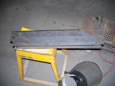

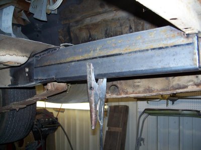

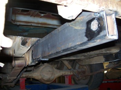

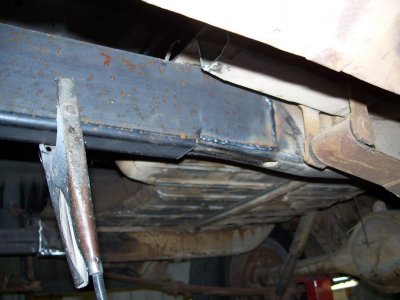

I got my frame caps cut and welded in.I used 2x5 rectangle and cut to the shape.The hole is for the tapping plate were the bumper bracket attaches.I plan on using 2in. square to tie the rails for the hangers into the trunk extention and main rail after I get new floor extentions cut and welded.[/B]
