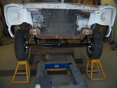

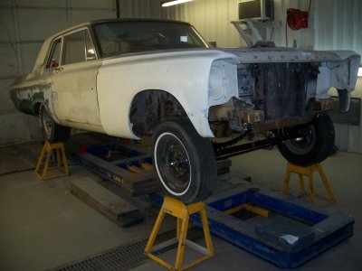

Got the glass fenders bolted on,need to do some more fitting,typical fiberglass stuff.The axle is tacked in,Speedway 50in. got springs ordered.38in total with 16in front segment 22in rear.I moved the front 12in. I hate the look when you center the front wheels with a higher front end stance,looks like your pushing a wheelbarrow.

I am planning to do this to a 65 Dart. Looking at the front axle, All components from Speedway? Please show what type and how to mount the steering box........Thanks for sharing the build with us.

I'm still weighing my options for a steering box.I might test fit the factory manual one it's still on the K frame so no cost involved there.

Pretty straight forward set up and era correct except for the disc brakes of coarse.

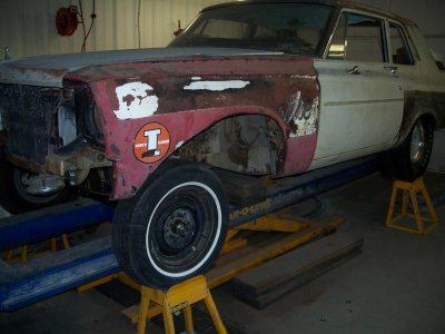

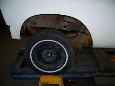

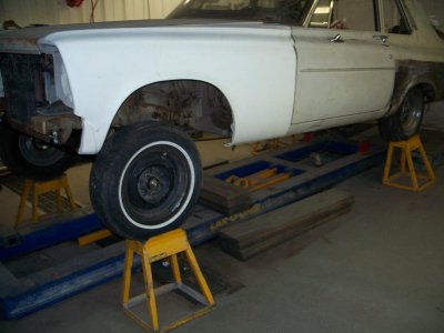

The altered wheelbase project has officially changed direction.I've been collecting parts so I can do a proper recreation/restoration of Tom McCroans the Funny Car for about 5-6 years now.I bought all the fiberglass parts from Jim Kramer,and started work with a very rusty shell.But now with this shell it will back the job way easier and will go much faster.Last shot is the old shell with patch work quarters

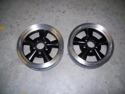

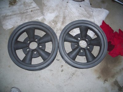

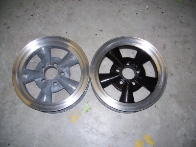

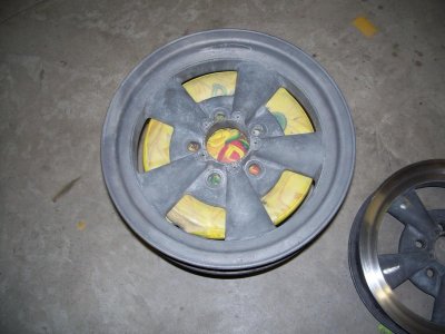

Spent a little time today cleaning and painting the magnesium front wheels.I need to get the tires mounted so I can get the front end location locked down and welded in solid.Got my new front springs also.
