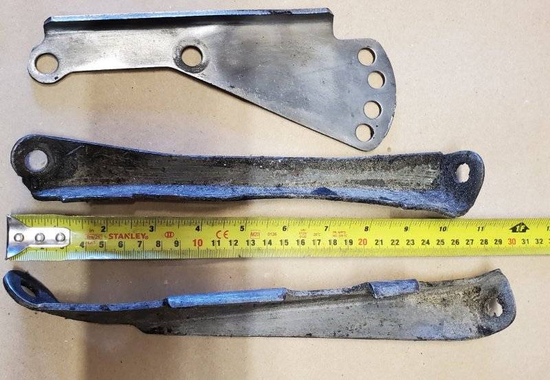

Identify these brackets?
bxmas13
6:27 AM
May 31, 2022
7
3
Utah
I can't seem to figure out what/where these( see photo) brackets go.
I believe they came off a 318 I pulled from my 66 Belv.II, however I could mistaken.
Sadly I have had two 440's and the 318 sitting in my garage for so long I forgot which part belongs to which.
Any help is greatly appreciated!
Two lower brackets go from the engine block to the transmission bell housing on small blocks. Other one I don't know.
Top one looks kind of like a shifter pivot that mounts to the pan rail. Not sure though.
Top one looks a lot like a wheel height adjustment bracket for a push mower.:lol:
could be thinking that since I just mowed the grass!
Awesome thank you!
One of the 440's did come from a motor home, I wonder if that could be a shifter pivot from a motor home.
I appreciate your time and responses, it really helps!

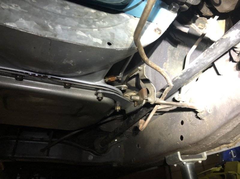

My '66 Imperial has a factory linkage bracket that bolts to 2 of the transmission pan bolts, so that's a good possibility.
The top bracket reminds me of the aftermarket shifter cable bracket that bolts to the trans pan bolts(with spacers). The one I'm thinking of had a small u-bolt to hold the cable with two nylock nuts. If so, that one has two locations for the u-bolt.
Grab a trans pan and see if the holes line up.
