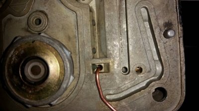

Here comes an update.
I went down to about 0.015-0.02 inch on the secondary t-slots but it did not help, idle was to rich.
I removed the washers on secondary.
Now i have about 14 on idle and when tipping on the throttle it goes richer and not leaner, so tip in is gone atleast.
Went down to 77 jet on primary and 80 on secondary, running at 13-14 on cruise and 11.5-12 on WOT at 4000 RPM.
Today was a very hot day, so i will check AFR another day.
Idle to WOT in gear is still the big problem, big hesitation.
Fun thing is that for about a month ago i tried with the blue acclerator pump cam on the secondary and the car did hesitate ALOT, it almost died as soon as i hit secondary.
I thought i hade mounted the cam the wrong way so i turned it backwards and the hesitation was gone.
So when i mounted the accelearot pump cam backwards it was running ok on idle to WOT in gear.
After i changed the accelerator pump arm to a new as i bent the old not on purpose its not possible to mount the cam backwards as is pushes the pump all the way in directly and make the secondary stuck linkage to stuck.
Really dont know where to start on the accelerator pumps to be honest, as the AFR says its running lean but i already add very much fuel.
