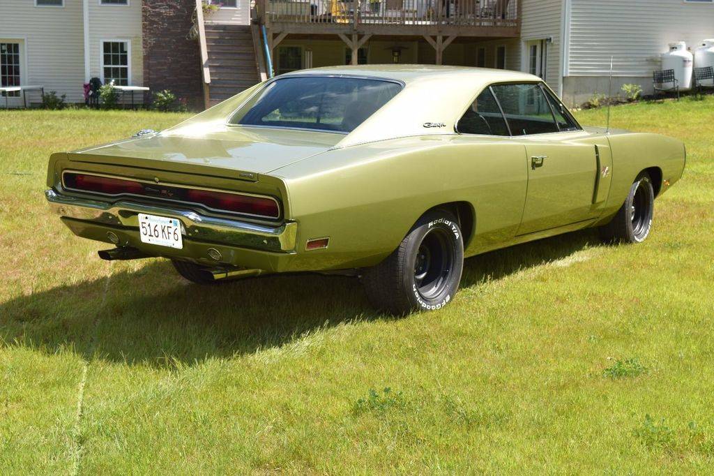

"THIS CAR RETAINS ITS ORIGINAL FLOORS, ROOF, FENDERS, HOOD, TRUNK FLOOR, TRUNK LID, DOORS, ROCKERS"

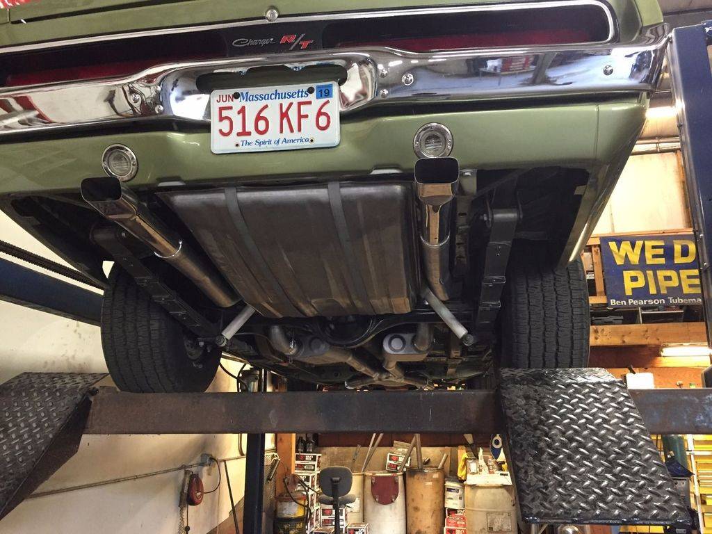

Replacement trunk floor without drilling out the body plugs or just painted over the body plugs? It's missing the wiring hold down straps on the quarter extension, broken fuel sender wire. Either the quarters have been replaced, or something has been done to them. Note the brushed on shmoo.
Definitely some replacement metal here...
Wrong wood grain, poorly "restored" gauge faceplate, no A-pilar covers, inner door shell should be painted black. Didn't take the time to vacuum the rugs.
Wrong bumper jack & no spare tire...
No rear bumper guards. Flowmasters....be sure to bring your earplugs.

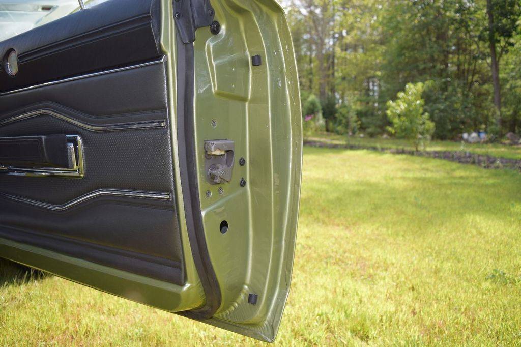

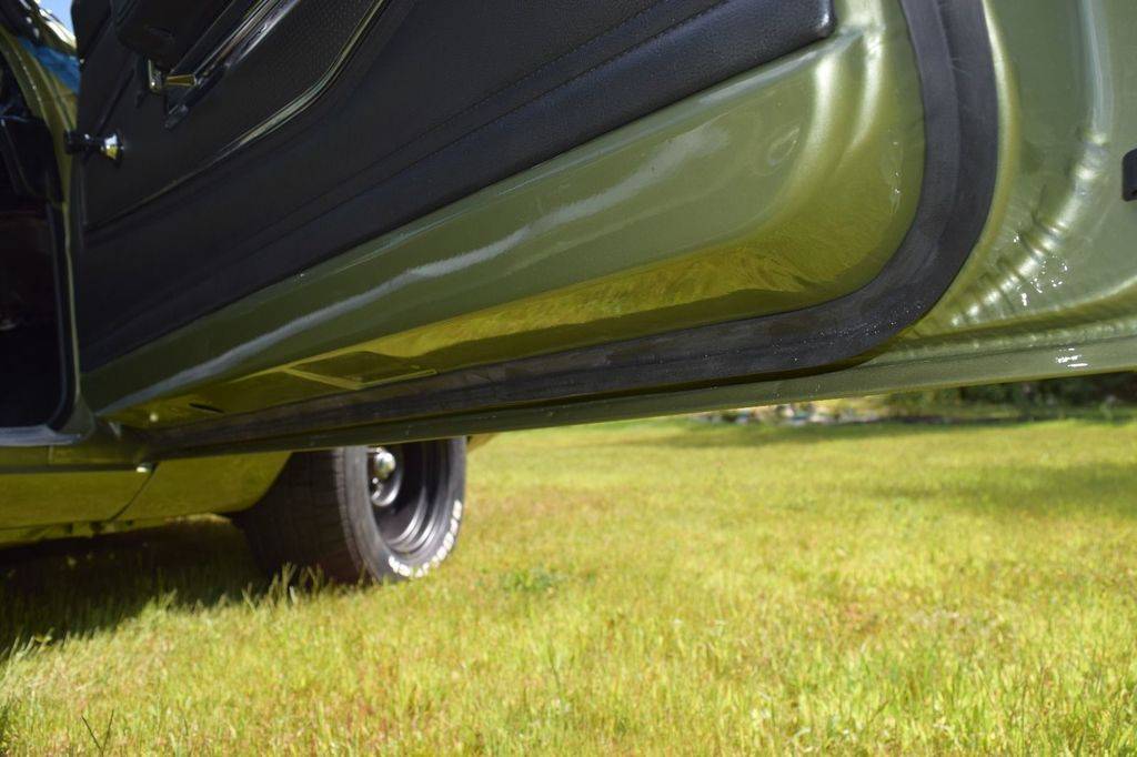

"THESE JAMBS ARE SWEEEEEET!!! Take a look closely at pics of all other cars out there and see how nicely detailed they are, then check ours."
Missing door body plugs, painted door strikers, should be painted black on the inside of the gasket.

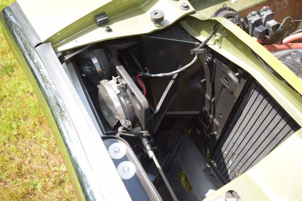

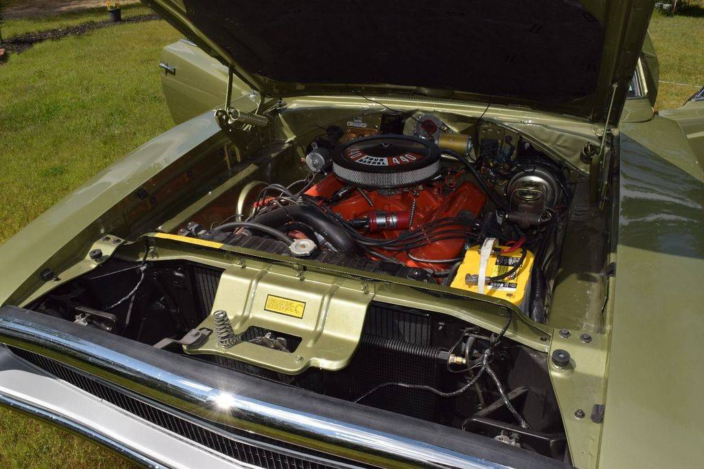

Missing fender tag, washer bottle, a/c condenser & all other a/c equipment, wrong air cleaner, no heater hoses, master cylinder, power brake booster, wiring. plug wire routing. Better pictures would show much more that is wrong under there.
What's with the funky relays?
Vinyl roof moldings, but no vinyl roof. What's that emblem on the trunklid?
