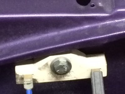

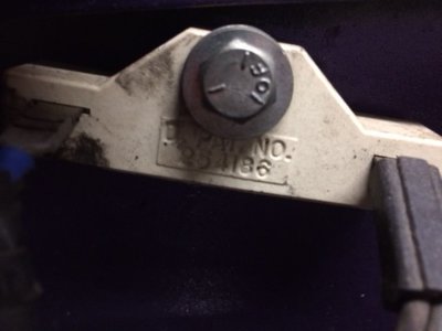

Yes, if you're not using an MSD box use their resistor... It ensures proper voltage to the coil
If you don’t run the resistor with the chrome or orange box electronic ECU you’ll fry the coil in short order. You may not notice anything amiss at first but it will surely leave you broke down somewhere.

I have what looks like a resistor on my firewall (see attached photos). Will this resistor work with the MSD blaster coil (seemed to work with the Jacobs coil) or should I replace this with the specific MSD one?
