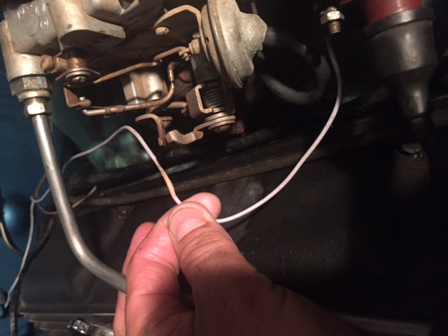

I had just changed the spark plugs on my 68 Road Runner, and took her out for a ride. Coming off a stop sign, she sputtered and died. I tried to restart but the starter motor would not turn. The ignition switch did light up the oil light on the gauge panel, but did not start the car. Just nothing.

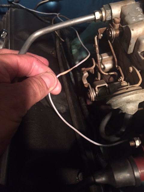

I went under the hood and found a light gage white wire running from the ignition coil to the firewall. At the firewall, it passes through a grommet as a lone wire. A small run of the insulation was melted to the cylinder head. I must not have notice that it fell into a hot area. The insulation looks as if it is melted but the wire looks like it should be intact. I am not sure what this wire is, or if it is the cause, but it's the only thing I can find that looks wrong.
Any suggestions would be appreciated!
Thanks,
Jay

I suspect that wire in your hand goes to the Tachometer. If it has shorted to ground, it is possible to kill the ignition....only because it connects to the coil. :thinker:
I agree as I was going to say it looks like someone added a tach and thats what the white wire is for. And if it shorts to ground it can kill the ign. It should still crank so I would check the starter system out to see why it wont crank. It may have blown a fuse link but that white wire would most likely be melted alot if a fuse link blew. There is a fuse link to the ign switch that feeds the ballast and coil but I dont think it blew that. Jump the starter at the starter relay and see if it cranks. Ron

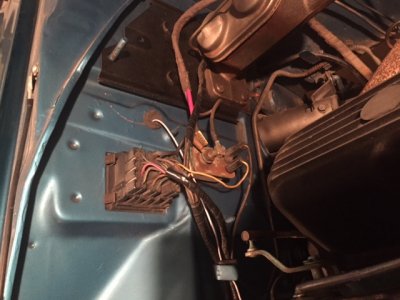

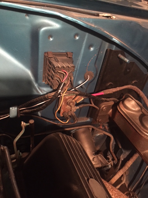

Not to go off topic but, the bulkhead connector should be cleaned up soon to prevent electrical problems. Take each bank off carefully without breaking any ears off. Then spray the crap out of it till it runs clear with electrical cleaner. Reassemble.

Dennis H, I'll be working that bulkhead connector block tomorrow. Good suggestion!
