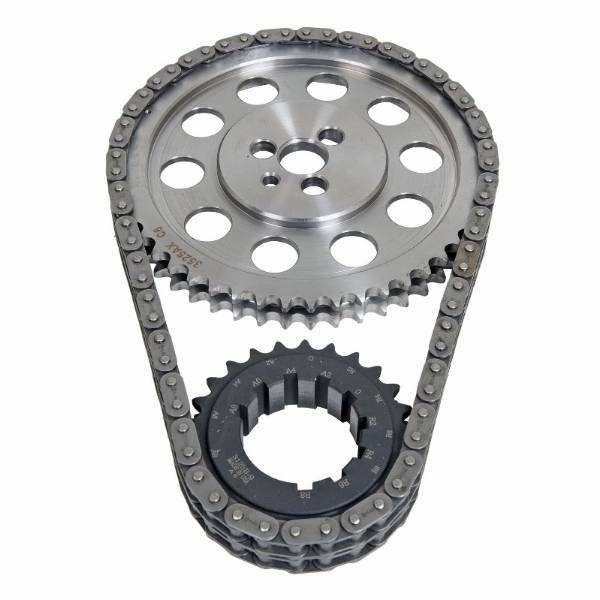

Summit Racing™ Billet Steel Timing Sets SUM-G6606R-B​
Part Number: SUM-G6606R-B
Summit Racing SUM-G6606R-B - Summit Racing™ Billet Steel Timing Sets
$99.99
Timing Chain and Gear Set, True Roller, Double Roller, Billet Steel Sprockets, Mopar, Big Block, Set
See More Specifications |
Timing Chain Included:
Yes
Timing Chain Style:
Double roller
Camshaft Gear Attachment:
3-bolt
Maximum Advance/Retard at Camshaft:
4 degree
Maximum Advance/Retard at Crankshaft:
8 degree
Cam Gear Included:
Yes
Cam Gear Material:
Steel
Crank Gear Included:
Yes
Crank Gear Material:
Steel
VVT Gear Included:
No
Tensioner Included:
No
Thrust Bearing Included:
Yes
Bolts/Studs Included:
No
Gaskets Included:
No
Offset Bushings Included:
No
Quantity:
Sold as a set.
Notes:
Includes torrington bearing.
Special Attention:
3-bolt cam gear.
