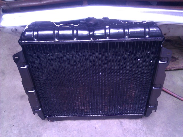

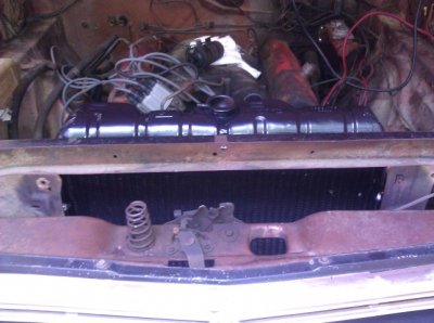

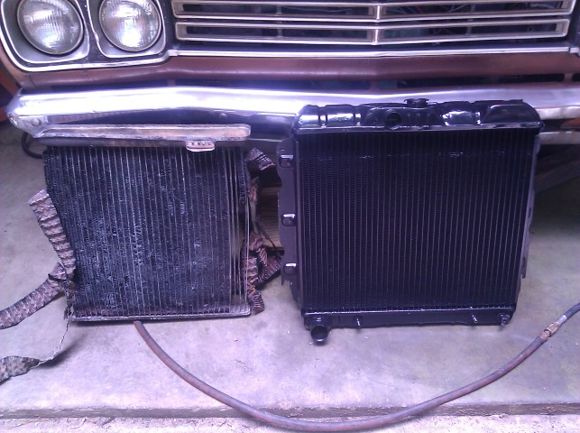

Had my radiator re-cored and got it running with that Holley3310-1 that I rebuilt.

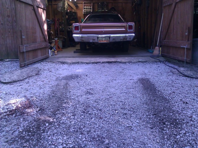

I turned the car around 180 degrees to pull the engine.
LOOK, the Sure Grip works.

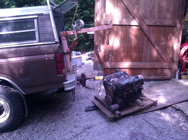

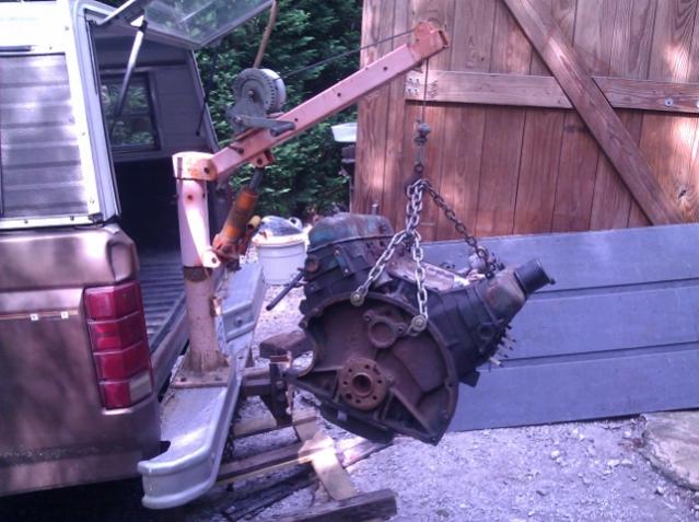

I've got these pictures so far of me getting it out of the way and into a trailer. :)
My problem is lack of time. But I am curious what is in the engine.
It's got the wrong oil pan and pick up on it right now.
Just to have something on it.
