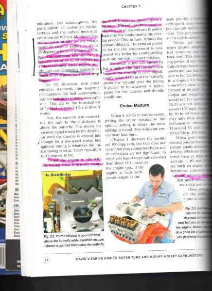

Geoff2 is also correct on the initial timing - but leave it where it is and connect the vacuum advance over to manifold vacuum for trial purposes.
Make sure the vacuum unit diaphragm on the distributor is on the lightest setting as your engine vacuum reading is low.

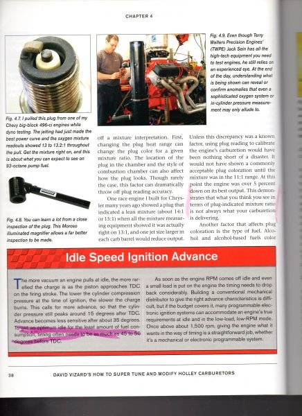

Initial timing is waaaaaaaaaaaaaay too low for optimum idle quality, vacuum & tip in response. See below.
Metering rods move as they should, I have had the same timing for over 15 years never had an issue, so I am really not willing to change that since this problem happened out of the blue and the timing was checked and remained the same.
My plans right now is to put my Firecore Distributor back in, it was set and built to my timing and specification and has been working great for two years now. with 24 degrees advance in to so my base is set to 12 for 36 all in, I can bump up to 14 with 38 all in but I need to get it to run when put in gear first. I am also planning on a new carb to see if this is the fix ( perhaps this EDDY dropped its Idle circuit). I was also told that the 650 is too small for my set up, the only option is the 800 and down tune it to work better. It will take me a few weeks to get the parts and try, if it still does not solve this issue,,,,,,,well it goes on jack stands and gets packed away. Anyone have an affordable 440 for sale???
