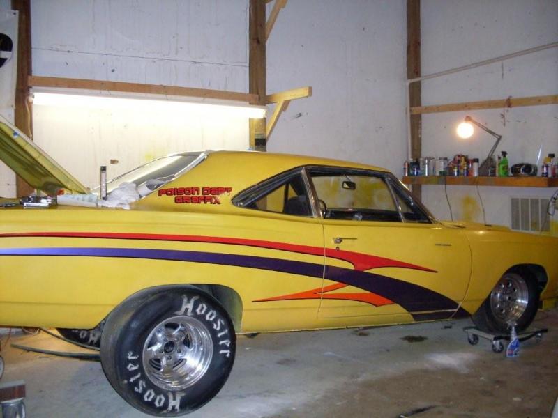

It will look like this...with an A body dana 60....wheels are 10 inch with 4 inch back space, small radials..

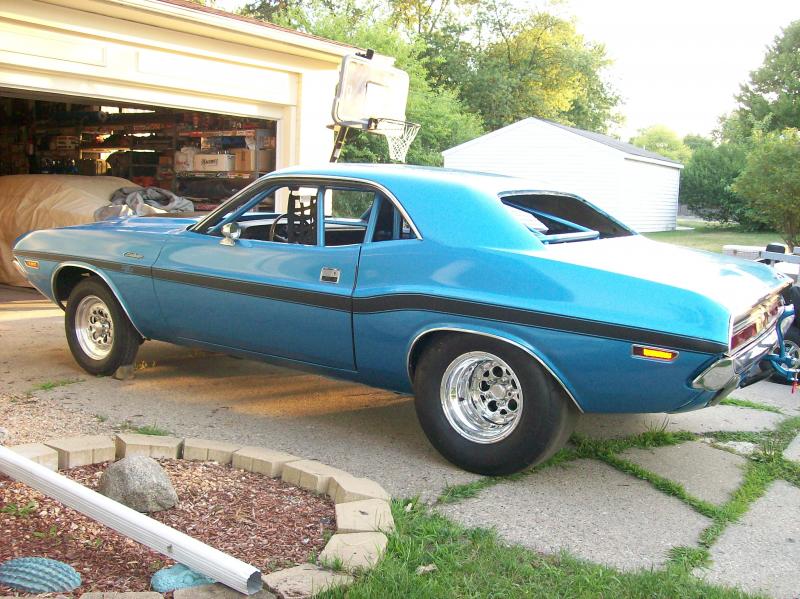

I have a mini tub, relocated springs & Cal trac on my Challenger ( I know E Body though). Can fit a 315/60 D.R. or a 29.5x10.5W on 12" wide wheels no problem.
