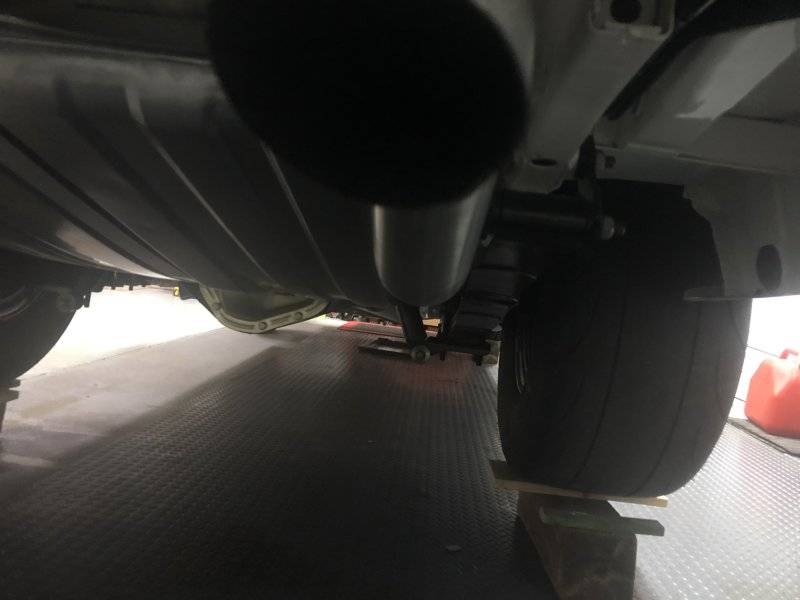

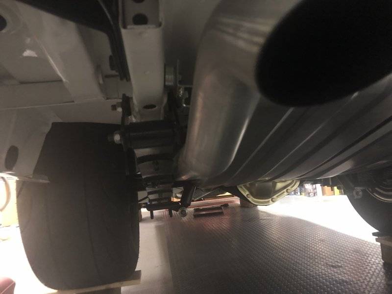

Lol, my buddy decided to relocate springs and mini tub his 64 after the car was already painted. Everything turned out great.
65Hemi, I thought maybe, would you have any pic's looking down the frame rail from the rear showing spring to gas tank clearance and where in relation to the frame rail the leaf spring is, you could post here?
