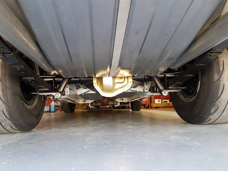

My 65 Coronet mini tubbed ladder bars coilovers Dana 60. I use 315x60x15 MT DR with 10 inch wheels with 5.5 BS.

The springs on my 65 are relocated into the frame rails. Narrowed diff and mini tubs too. Stock gas tank.

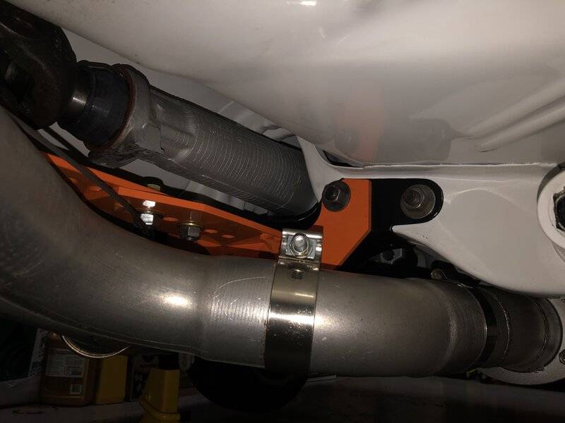

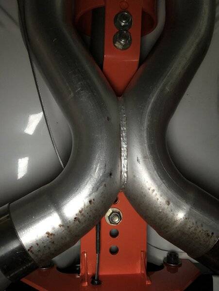

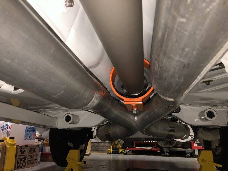

Here are some pics of my x-pipe and a 727.
View attachment 1028197 View attachment 1028198 View attachment 1028199
Wow, clean looking build, looks great. I figured i would have to make something up just wasn't sure. Thank you for the pics ,that helps a lot. I agree, an h-pipe after the G.V.'s unit would probably be the most logical way to go, fabricating the h-pipe mid section shouldn't be that bad if I can tie that into TTI's over the rear section. BTW, did you make the drive shaft loop or do you know where i can get one of those ?, looks to be another problem solver and way nicer than the one that i got with my car as a roller. Who's muffler/ resonator did you use?.

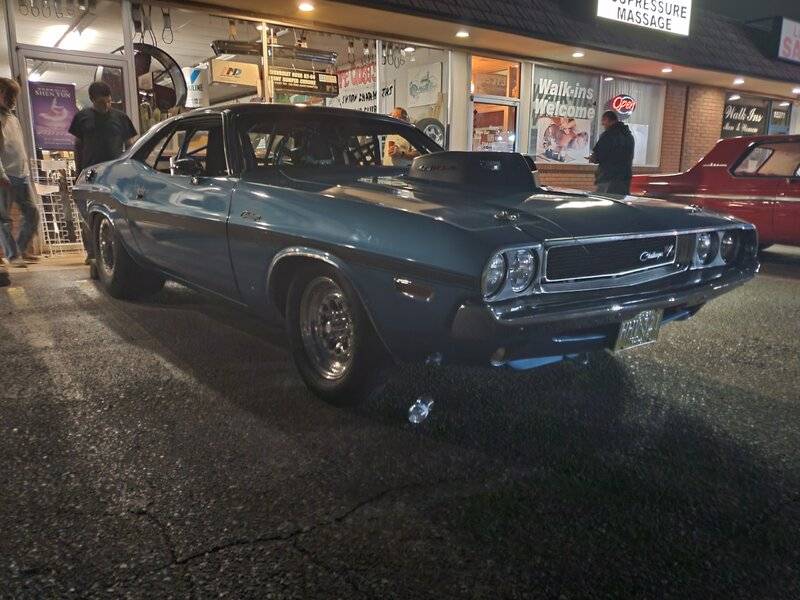

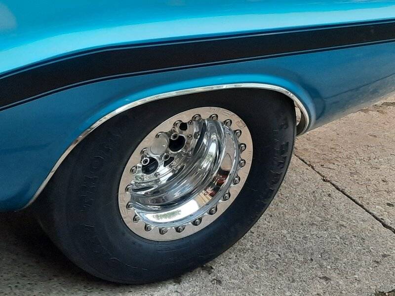

Not a B. Mine is an E body with mini tubs and springs relocated 3" inboard. I run 315/60/15 Drag Radials or 29.5x10.5w's on 15"X12" w/5-1/2 b.s.
