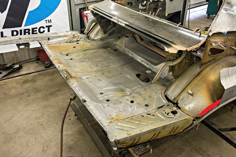

Any way to see the outer wheel well from the trunk? Or by taking out the back seat? Maybe lay some wet towels across the inside.
If he puts wet towels on the inside it will pull the heat from the panel he's welding... The place to use wet towels is on the outside painted surface...

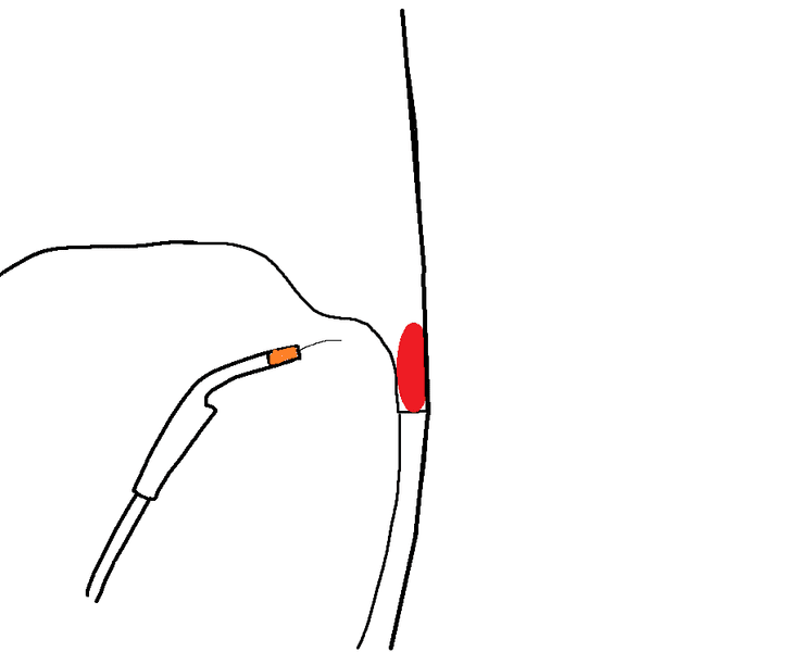

Possibly.. Just coming up with ideas lol My thinking was to lay it on top of the wheel housing next to the quarter. Kind of in this position. Shown with red line. Was also thinking the heat would soak into the towel without getting the quarter hot.
But he's welding on the wheel house right there & he's bringing the outer wheel house closer to the outer skin of the quarter panel...
Money bets hes welding from inside the wheel well not inside the trunk. If he is welding from under the wheel well then I think the wet towel would work. Again red shows towel placement. With thin sheet metal you would want to pull the heat away as fast as possible to prevent blow through. That's why some people use a copper block behind a thin sheet metal joint.

Crude but hopefully you can see what I am talking about. Maybe I am just a nutjob.
But the wet rag cannot contact the piece of metal you are welding on. In that area, it would be impossible to accomplish this.

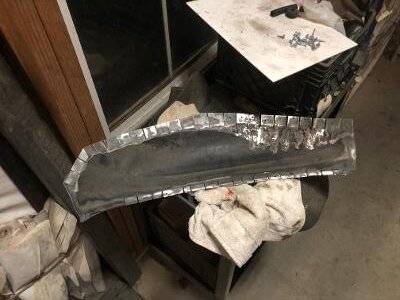

Since you can still remove the patch, why not weld up the gaps off the car, form them as needed and then finally panel bond the patch in?
Again, just brainstorming...
I was thinking the same thing, but would imagine it would distort from the welding heat and not fit nice and snug like it does now.
Yup, totally agree. But since it is off the car he can reshape it as needed to get it to fit right. Hopefully though, with slow and controlled welding, he could minimize warpage.

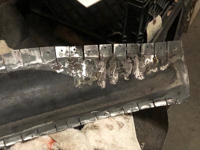

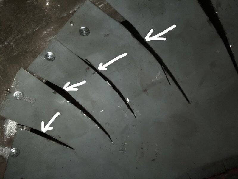

That is exactly what I decided to do.
I welded up the gaps in the right side first.

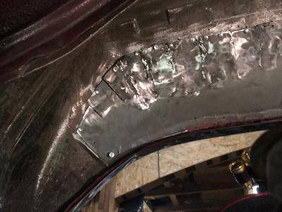

The left side was next. I didn't finish tonight....I had to close up shop and get cleaned up for dinner.
Well, I messed it up.

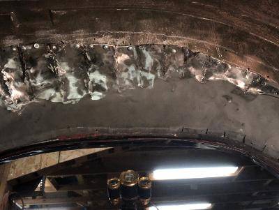

The left side had some longer cuts that required more welding than the right side. Welding off the car seemed to be going okay. I test fitted several times but I tried fitting it today and the gap at the top was too much to pull closed with screws. I was concerned that trying too hard could maybe distort the quarter panel.
I ended up screwing the LH patch in at the bottom and sides, then I cut through the welds and let them spread open. From there I screwed the flaps to the existing tub. I welded up the gaps in place.
I'll dress the welds a bit more. I should be able to "glue" the patches in place tomorrow.
