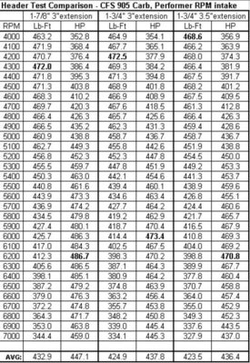

I saw a 13hp difference peak to peak on my 480hp 383 going from 1-3/4x3 to 1-7/8x3.
In the upper rpms there were points where it was 20hp+.
There were only a few lines down near the beginning of the pull where the 1-3/4” made more tq than the 1-7/8”....... and it was only a couple of ft/lbs.

383 test.
It would make sense that there would be a bigger difference if that same test were done on a 511 making 600hp +/-......... depending on what parts were chosen to get you there.
Funny the 13/4 with 3.5 pipes hurt the numbers interesting!
