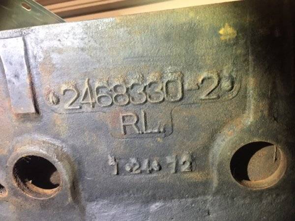

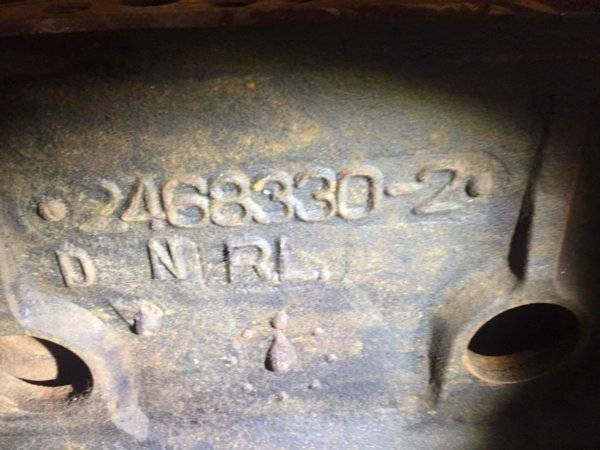

Just bought this Hemi block with a few other parts but the casting date does not make sense.
It looks like my '66 production block but the head bolts and bearing cap side bolt holes look to be 1/2". Is there any value in a block like this? Thanks for looking and for any info you can share!

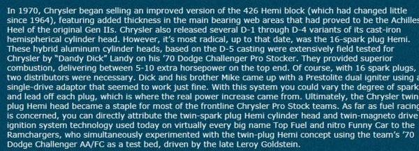

There were kits to convert to larger main and head bolts/studs. Fuelers used them, high horsepower engines. They cast hemi into the 70's. Tried to order a block in 1978, none available.
Check the 1975 Direct-Connection catalog. Page 9. The fuel block also had heavier webs, if I recall correctly.

Great info in the article! And, I will definitely be taking a look in the '75 D.C. catalog (a friend has one). Sounds like this block will hold up to more than I'll be throwing at it and is a better block than the '66 casting. Seeing that the '68 Charger is a 4 spd /Dana 60 car, this block is the better choice of the two for that car. Off to the machine shop after the holidays ---- fingers crossed. Thank you to everyone for sharing your wisdom and Merry Christmas!
