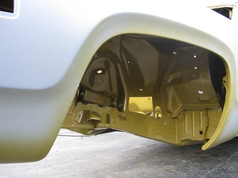

I've looked around and found various threads about opinions on removing inner fender rust. Outside is no problem to sand, but the inside is contoured and has bracing so it may be more difficult.
What is everyone doing nowadays to remove surface rust from the inside of the front fenders? Goal is to get them down to bare metal to prime and paint. I've read horror stories about evapo rust gel so that's out.

I blast inner fenders and firewalls without issue, there are enough curves and contours to hold it in place...... if these areas do actually warp a little, I have never noticed
if the car is together, you need to mask it up tight; once you got your ducks in a row, it's pretty fast and simple
