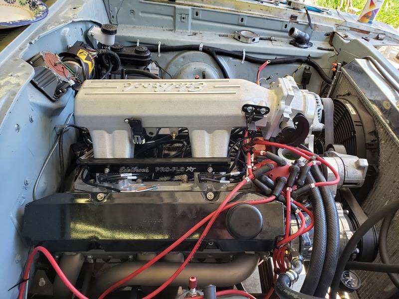

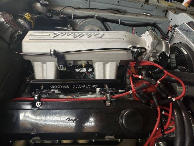

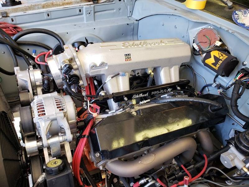

Started the Install.
Notes so far..
1) Fuel inlet on wrong side.
2) Coil placement?
3) Air Filter?
UEhMZ8WjtWgyMRKBU44UDy8g4oBgwejAkM2r0oe2jd1DLX6e92QvQOU2WhL7cTaLq9XQjF2AaKm70DyYmg=w1250-h937-no.jpg
lNAOu_a6iey1hAXS95tz7Ll5lRi9mbEgH-qNXedPntw288-QbXejpIZ_6K0ajhM9Ek8TcGcpytssAjcWUg=w1250-h937-no.jpg
Looking good!
I bought the 440 Source valley cover and I plan to fab out a coil bracket that mounts to that, putting the coil longitudinally under the plenum of the intake. If that doesn't work, I'll mount the coil on the inner fender and extend the coil wires to reach.
I figure a simple right angle 90mm charge tube from Spectre or similar will work for air filter. A quick search through Summit and Jegs showed lots of possibilities. If not the shop guys and I will come up with something.
BTW is that an SD Concepts serpentine kit?
Tim

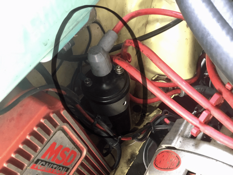

Gotta keep the coil and it's noise away from the Injector harness.
Yes, it is the SD Concepts.
Valaya put mine forward passenger side next to the tired old MSD Box.

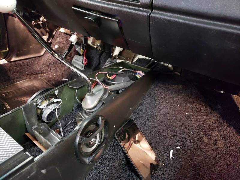

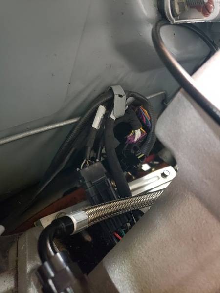

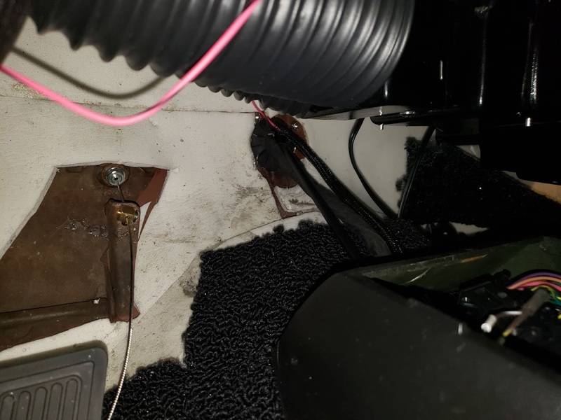

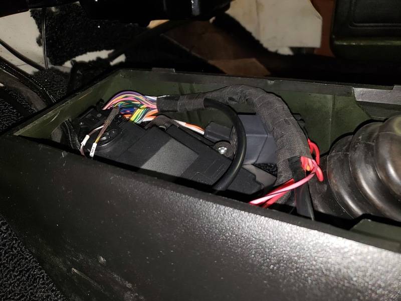

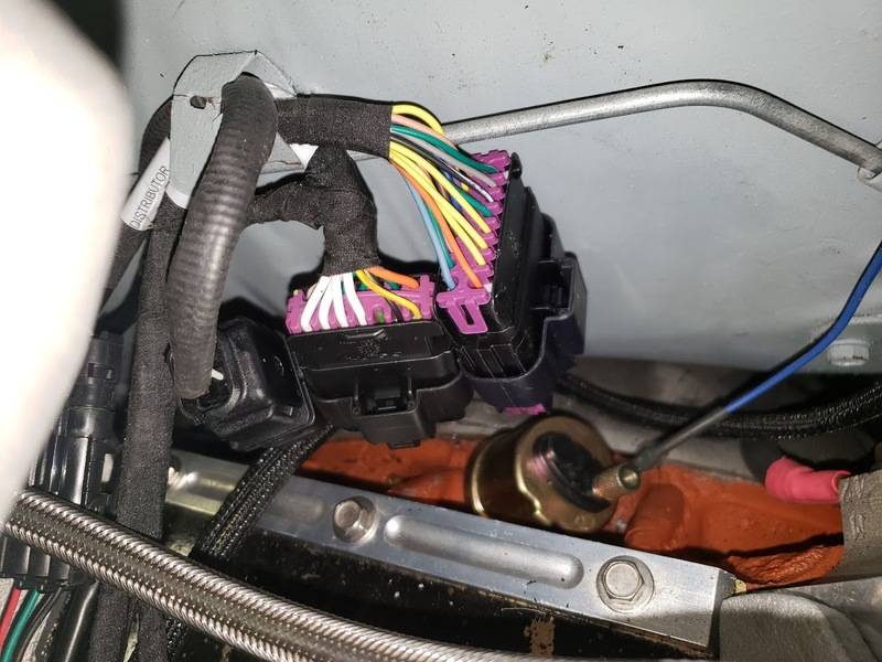

Got my coolant sensor and throttle cable and did a little work last night. Forgot pictures. Paining over making a hole in firewall for the harness so I can mount the ECU under the console.

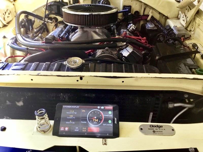

Check this. Chevrolet install 67 Camaro. Note ECU and Coil placement.
