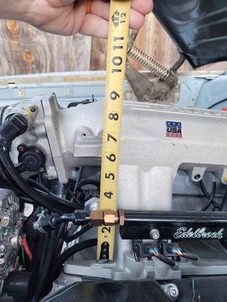

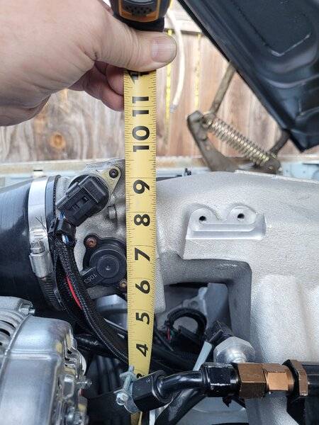

The first picture is from the Stamping pad, second is from the first manifold bolt..

Good stuff, I appreciate that! It looks close. I guess the only way to know hood clearance is to install and see. Does your Charger have a 440?Like a Turbo...

Yeah.. I had to get a fiberglass hood, but it was due to my Serpentine setup and not the F.I.. It was close.. To be honest, I am good with the Fiberglass...Good stuff, I appreciate that! It looks close. I guess the only way to know hood clearance is to install and see. Does your Charger have a 440?
I would need to re-route AC hoses and tweak the upper rad hose at the very least, but that is minor compared to a hood work. You've been a BIG help, thnx!Yeah.. I had to get a fiberglass hood, but it was due to my Serpentine setup and not the F.I.. It was close.. To be honest, I am good with the Fiberglass...
Even if I get a new serpentine get, I will stick with Fiberglass, 70 hoods are gold..I would need to re-route AC hoses and tweak the upper rad hose at the very least, but that is minor compared to a hood work. You've been a BIG help, thnx!
Like I said, I am great at spending your money.. If you have any issues, let me know..I would need to re-route AC hoses and tweak the upper rad hose at the very least, but that is minor compared to a hood work. You've been a BIG help, thnx!
I used CFV serpentine and went with the low mount compressor option. Puts the compressor right where the Vintage Air hoses enter the engine compartment on the passenger side of the motor.I would need to re-route AC hoses and tweak the upper rad hose at the very least, but that is minor compared to a hood work. You've been a BIG help, thnx!
Hmmmm, that's a pretty good idea. The hoses have always been in the way of the distributor especially. On the other hand I'm wondering why I opted for AC in the first place.I used CFV serpentine and went with the low mount compressor option. Puts the compressor right where the Vintage Air hoses enter the engine compartment on the passenger side of the motor.
