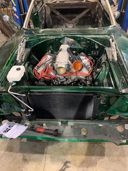

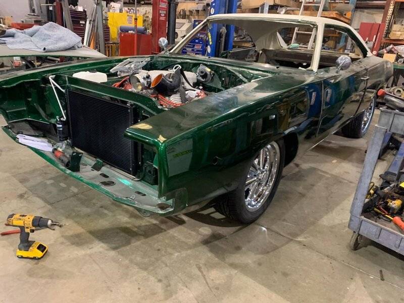

Here's a couple engine pics:

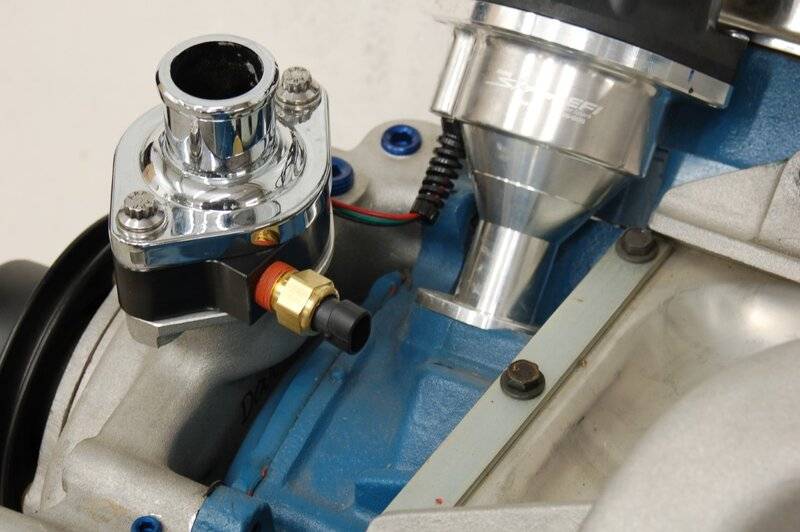

Wow, thnx for the quick reply! Great news on the hood clearance, that's my biggest concern cuz I love the stock Charger hood man. What did you use for coolant temp? Can I just piggy back off of the stock sending unit?
You got a couple of options.. 1) Aluminum water pump housing, it has 2 temp sensor places.. 2) Dakota Digital with a can bus adapter from the Pro-Flo..
What Durwood said. I had to go with the newer aluminum water pump housing from 440 Source to use the CFV serpentine system. Stay away from the cheapie Ebay ones, ask me how I know lol. It had the second hole. I did move the factory temp sensor to the secondary hole because of hole size.

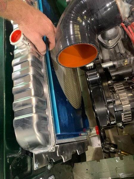

The only issue is, you are going to run a air intake hose right over top of that.... Plus, another surface to seal..
Your pro-flow will give you temp read outs on the Tablet.. I would use that or maybe a can bus gauge cluster like the one from Banks.
I had to got with an upper outlet with a 60 degree angle on it. It clears the air intake and lines up with the upper radiator hose fitting.
