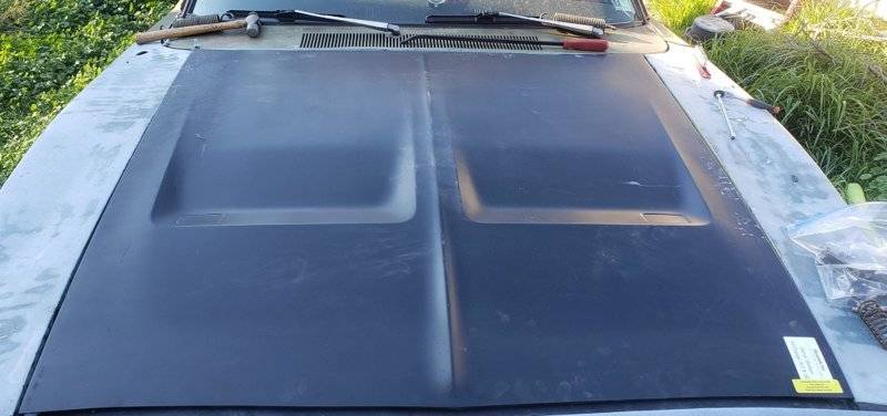

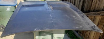

Got my Fiberglass hood, Fits nice, Just needs some tweaking
Looks good. How does it feel in terms of weight difference? Maybe half of the stock hood?
I don't remember if this was a bolt on design or to be used with pins.
It is a bolt on hood, but they recommend pins, so I am going to install some flush mount pins. Just for piece of mind..
Half the weight of the Steel hood.

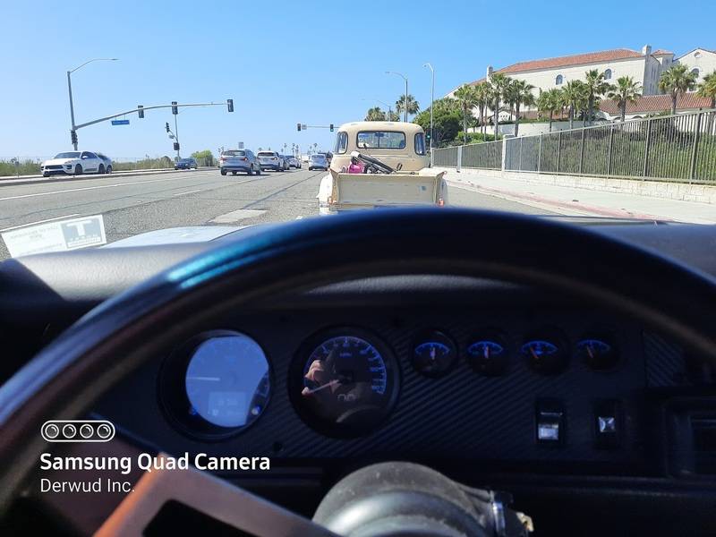

Took the Car out for a 120 mile cruise for the Quarantine Cruise in Orange County, CA. Car ran flawless and never missed a beat.
2K RPM at 75MPH and actually got pretty decent MPG.

Looks like a Dakota Digital gauge panel.
Other than the gauges, what info are you using the LCD data panels to display?
