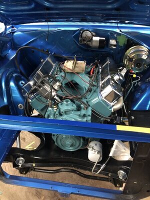

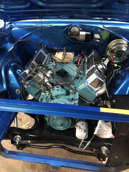

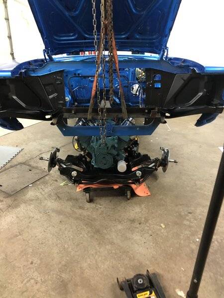

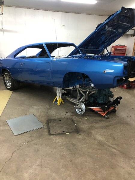

Installed mine (Hooker Super Comp) from underneath with 4 speed no issues

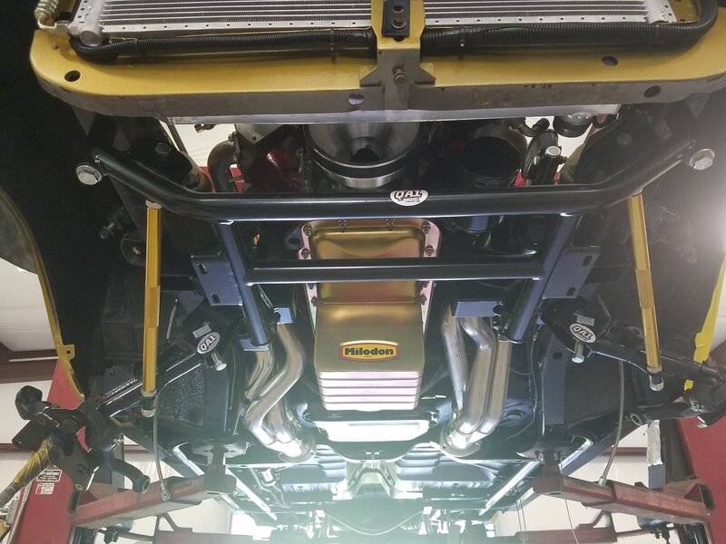

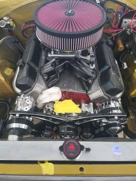

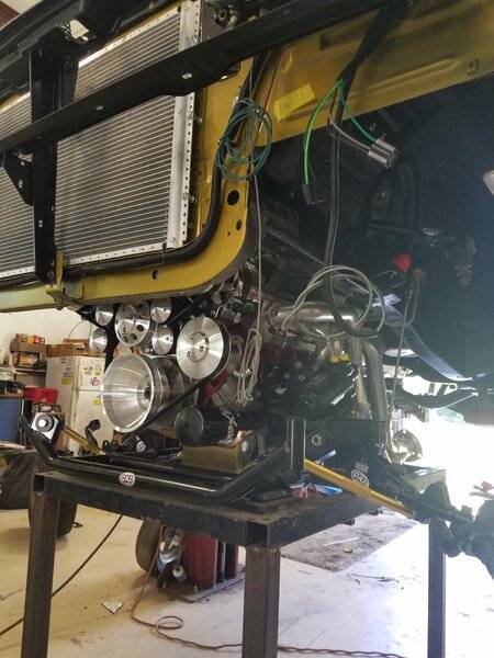

No problem. Its the only way to do it! Mine are 2" primaries w 3-1/2" collectors.

With the Tremec, it is the only way.. The amount of work getting the trans in with the Engine in the car, I ain't doing that again.

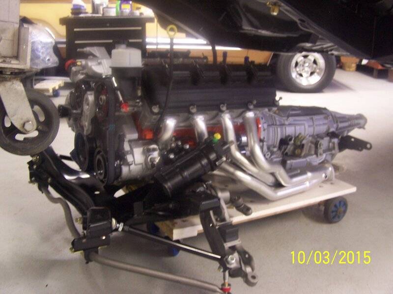

In my case putting the 6.1 in my 68 Charger, it was a 20 minute job from underneath. With the torsion bars out, there is nothing in the way. 4 bolts in the K frame and 4 bolts in the rear cross member
