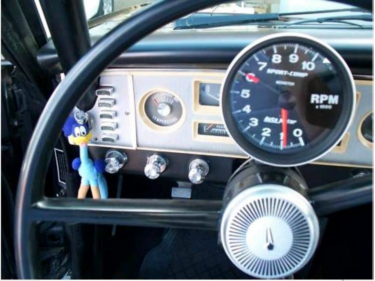

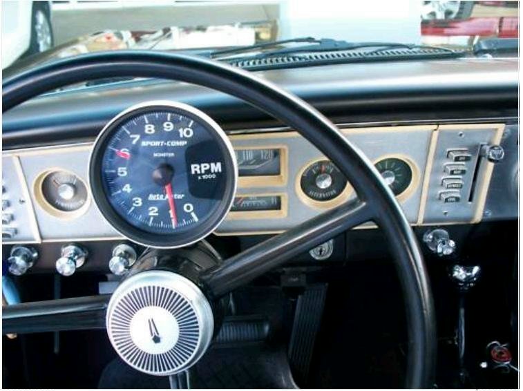

Hi folks!
After having sold my Challenger and now being proud owner of a `68 Roadrunner, I also switched boards from "febo" to "fbbo".
My first post is a question regarding the Instrument-cluster/dash-panel the previous owner installed to my Roadrunner. He didn`t knew more than it should be "from an early `60s Plymouth".
Does anyone of you know from which car + year my instruments are and what it would take to make the speedo work with my 727TF-trans?
Picture attached below.

Hello Tobias!
Crazy, you've got that Dash in a 68 Roadrunner???!!!!

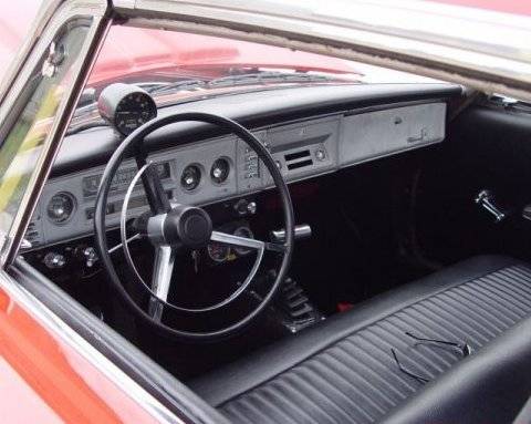

To me, it looks like 1964 Dodge!
It's got the push buttons in the left, for shifting.
later 727 will not work with pushbuttons, the missing mount for the push button-cable is the reason, I think.
You will need a column with a stickshift or console.
Please correct me!!!!
I only have a few exterieur parts for 68 Roadrunner (Taillights and Trunklid trim)
But I think I know one, who could have something for you! I will send you PM with his adress.
I'm from Germany too, so no overseas shipping, if you're intersted in parts!!

Sorry for misunderstanding: I don`t want to make the "push-button"-selection work with my TF727, I am happy with the console-shifted TF727 installed. I just want to make the speedometer work with my TF727. Maybe anybody can help here? Was the `64-Polara also available with a TF727 and was that Polara-TF727 transmission available with console-shifter?
Thanks in advance!
dash
that panel is for a 64 Dodge polara it was avaliable with both.you will need the later s piece speedo cable assbly. the early one had a small housing on the trans.end
LOL....that pic from postman is an actual 64 Dodge kdtjb. Looks like someone heisted a late 60's Dodge steering wheel and tossed it in that 64' though.
These are great news, thank you Steve! So there are quite good chances to make the Polara-speedo work in my Roadrunner :))) I am gonna crawl the year-one hp for the required speedo-cable.

The pic in my second post is from the net! I only wanted to show a 64 Dodge Dash!!!
Didn't want to confuse!!!
You can see the RR hood and fender in the first pic. That's just crazy!! Never seen anything like it.
Is that a roll cage I see in the second pic? Welcome to the site from the Motor City.
Thanks for welcoming me here aboard (all of you). Yes it`s a rollcage in my Roadrunner and yes, the previous owner did also fit an instrument-cluster of a - as I now know thanks to you guys - 1964 Dodge Polara.
