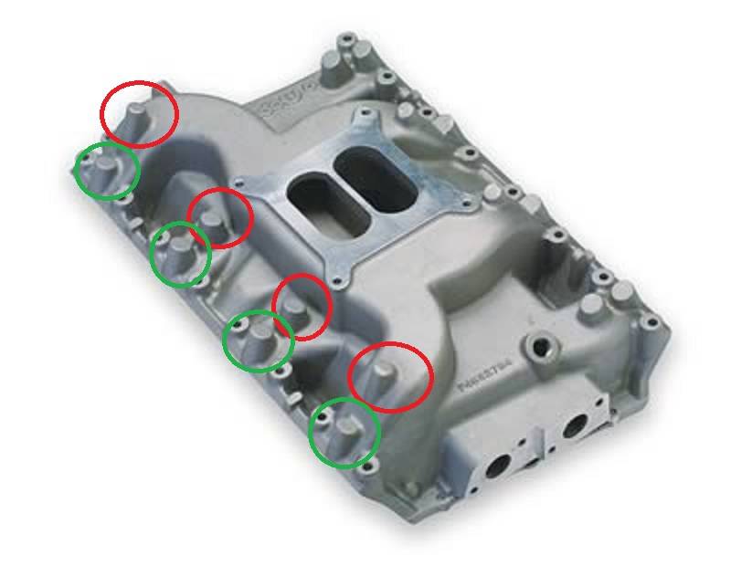

I'm planing to get fuelinjection for my 426 Hemi and looking for a intake.
It looks like the M1-intake have some kind of bosses for injectors, or am I wrong?
It looks like two rows of bosses.
I have circled them in red and green...
Can they be bored out and used for injectors?
You could very well be correct. However, one of the bosses is probably for the injector and the other is to be threaded to hold the fuel rail or injector in place. Check different injector designs to see if they look like they will fit this pattern. It's my guess the green circled boss is for the injector.
True. The mopar.ca site mentions that the P4876188 manifold has the bosses but still requires machining.
