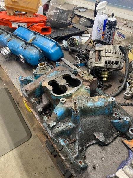

So I pulled the heads on my 74 Road Runner 340 to do some valve work and drill out some broken off bolts. I think the original intake weighs around 10,000 pounds.....I'm thinking an aluminum upgrade...any recommendations?
If you go for an aluminum replacement, I would suggest you stick with a dual plane manifold. They help with low end torque which your 340 needs (I had a 73 Road Runner with a 340 for 42 years). Overall, I don't think you will see a huge performance gain though.
Rangepony, All depends of the primary use of the car. Daily driver the aluminum Edelbrock Performer is a good one.
Basically the same as your stock cast iron. That way the use of the factory Thermoquad can be retained.If you still run one.
If I remember the stock cast intake weighs 51 lbs. Heavy indeed.
Anyway if you plan on more power and higher RPM driving ,the Performer RPM . But it is not a spread bore so a different carb or a spread bore adapter
may be needed. Watch out for air cleaner to hood clearance .
I agree with Darter6 it may turn out to replacing a bunch of parts. Not just your intake.
Big thing is if you are running a thermoquad you need a spread bore intake. Edelbrock Performer may be the easiest to find. Make sure the ports are opened up fully to match your heads.
Nothing says I've got nostalgia, period aftermarket correctness, direct connection recommended and coolness more than an Edelbrock LD340. I'd seek out one of those, just gotta be patient. There was a DC bulletin on modifying so that you could run the TQ. You might get lucky and find one already done.
That would definitely up the "wow" factor.
The Edelbrock Performer is pretty good for stock to mild engines, but the ports need to be gasket matched for a 340/360 as they neck down to 318 size near the gasket area.
On the one I have, the EGR / emission version, the ports are pretty much 340/360 size except about 1/2" (maybe a bit more) from the gasket, so gasket matching was pretty easy.
The Edelbrock RPM is a good choice if doing a performance build, or just want to run a square flange carb.

Perhaps additional info on the car/engine, and it's intended use may be beneficial. If your engine is stock, I'm not sure you'd benefit much on a low-compression engine. If that's the only modification done or will do.
Use what you have, unless you're racing for world record. Does the extra weight really matter? HELL NO! When you use the factory stuff everything fits. Spend your money elsewhere. For a street driven car, it's hard to beat the factory Thermoquad setup. I've been using them for 45 years, I won't use anything else!
I was surprised to see the regular performer out flowed the RPM version?
I was surprised how well the performer did in that. But, I guess there is more going on then just flow. Our first experience with a LA Edelbrock performer was when I was in high school. We learned of the port size the hard way when we pulled the 2 barrel off our 318 and 340 performer intake we had bought had much bigger ports. But, we preceded and installed the performer intake anyway. But, it ran great. We later replaced the performer w a smaller 273-318 port 4 barrel intake and it was a downgrade...the performer ran better. Even with the ports unmatched.
Just my thought, did it run good? I like stock but thats me. Why change it
It runs pretty good....I discovered some broken and cracked vacuum lines so it should be better when I get it back together. I like stock as well....I might need two or three guys to come help me lift it back in place!
