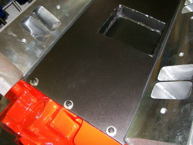

$100. shipped. Not working so how about around 75 reasons :( .... They do look nice though. Heck by painting and using the old one i have 55 miles of gas :) P1191658.jpg
yea the indy valley pan is sweet too ,but may have probs if your running a dual plane intake,gunna get clearance issues

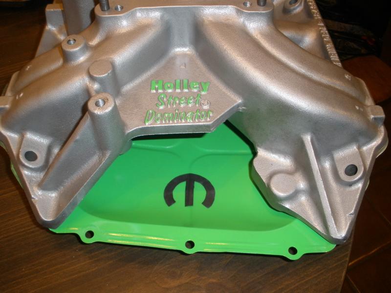

That's why I mod the tin as seen in my pic. I run a low deck and Street Dominator. The heat plenum high-centered the intake with a flat valley cover. Sure, a guy can cut the heat plenum off but why f u an intake?
