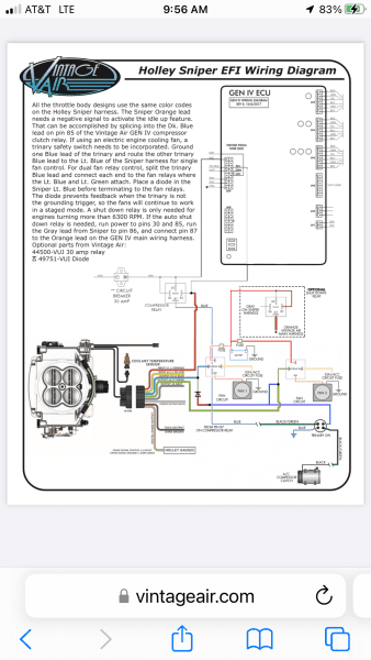

I’d just happen across this as I’m using Vintage air. They also show dual fans being controlled by the sniper. I’m guessing all I need to do is run the temp sensor wires straight in to the Holley. Wonder if I can wire both temp sensors together then run 1 wire in to the Sniper or do I still need run them separate like in the pic shown even though I want them both to kick on at the same time?
The way I read it you will only be using the sniper's temperature sensor. You will need to wire it the way the diagram shows with diodes and a trianary switch. You will then set each fans operations through the sniper's computer.
I have dual fans. The first one I turn on manually with the overhead switch panel on the cage. The second fan is controlled by my Racepak to come on at 180 degrees which it almost never reaches even in daily rush hour traffic. 176 is where it usually stays with only the one fan.
Yes that’s the way I took it but if you have both fans coming on the same time can you tie both wires green and blue together and then have 1 wire going in the sniper to have them both come on or do you still need to hook both green and blue separately? That’s the only thing I’m confused about.
Yes if you want both fans to come on at the same time you can control both relays with the one wire from the Sniper. I would use only one of the two wires and set the parameters for that circuit. Hooking them together could be an issue.
