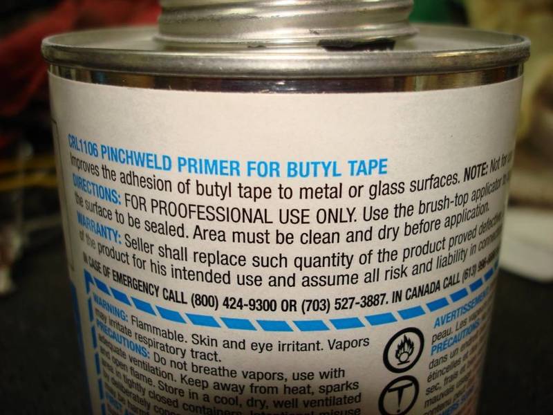

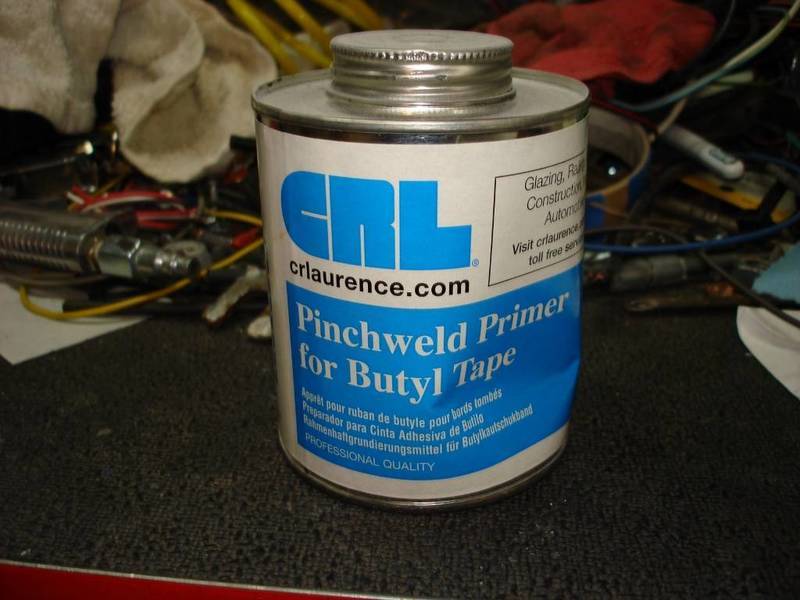

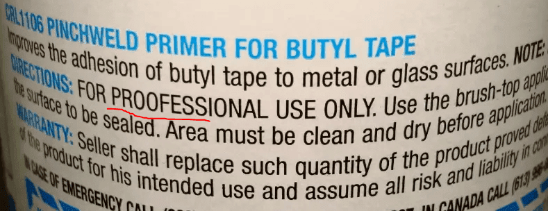

Curious a s to Country of Manufacture here....
I know you guys spell some words funny, but WTF is this language from?
It had to be the most important word of that statement too. :lol:
