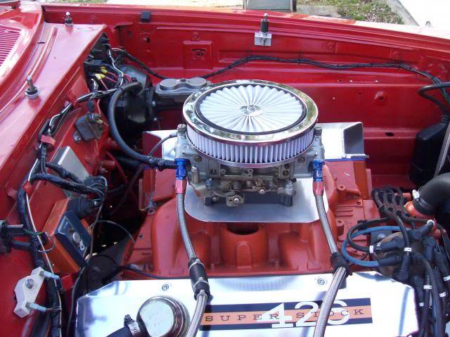

It will depend. We took the orange MP ECU off my sons Dart and put an MSD unit on it. It started and ran the same and was no faster in the 1/4 mile. But we bought this orange MP ECU around 1999 and it has worked flawless but I have been hearing the newer ones bought in maybe the last 5 to 8 years or so have been giving trouble and taking timing out at higher RPM's. We had none of that as thats why I took his orange MP ECU and put it on my 63 which starts great and runs 10's as a street car through the pipes and never misses a beat. So if yours is woking real good now you may not notice a difference. But if yours is not working up to par then you might notice a difference. You can see my orange ECU on my firewall that been on the car since I put it on the road in 2006. Ron
