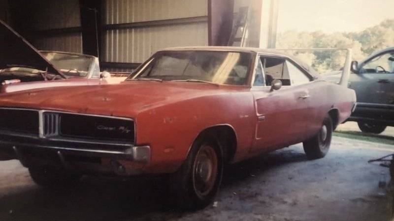

I'm asking because i'm looking for a 1969 Dodge Charger RT with a 440 right now
(most likely cant afford a Hemi Car except its pretty cheap and in driver quality maybe) and want
to do exactly that. Driving 130 to 150mph all day long. Well not all day long but for longer periods of time.
So can i simply put in a Radiator and Oil Cooler (maybe some better fans, pumps etc.) with Police Car specs or better and have basically
the same equipment with the same performance as the police cars installed?

Well i know that a 69 Charger RT with a 440 can do those speeds.
But what i dont know for sure (if you ask different people you get different answers) is if the Factory Stock cooling is sufficient enough for doing it for longer periods of time without overheating issues.
I know the Hemi Cars had Heavy Duty Cooling and the Police Cars also did.
Also there was a Trailer Towing Package for the non Hemi Chargers that basically also adds HD Cooling.
So i hope the Engines in Police and Passenger Cars are the same and the Police Cars just had Upgraded Cooling in form of HD Radiator, Oil Cooler and so on.
As far as Areodynamics go i hope it feels stable enough without modification because i like the set back grill from the 69' and also the non Fastback rear.
I dont really like the looks of the Charger 500.
Well the Daytona car looks pretty good actually but still not as good as the normal Charger RT.
Maybe adding the Daytona Wing would already help enough?
Does not look to bad on a normal Charger. :)
