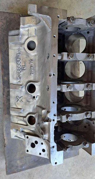

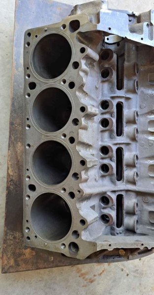

I saw this block for sale. It is listed to be a 72 casting made for drag racing. It is listed with cylinder sleeves to a bore of 4.100. It is said to be never used and shelved for 44 years. Appears to have four bolt mains. Why would an unused block be sleeved? Did Mopar do this for racers? My thoughts is it was sleeved from previous boring. Any input? Thanks.

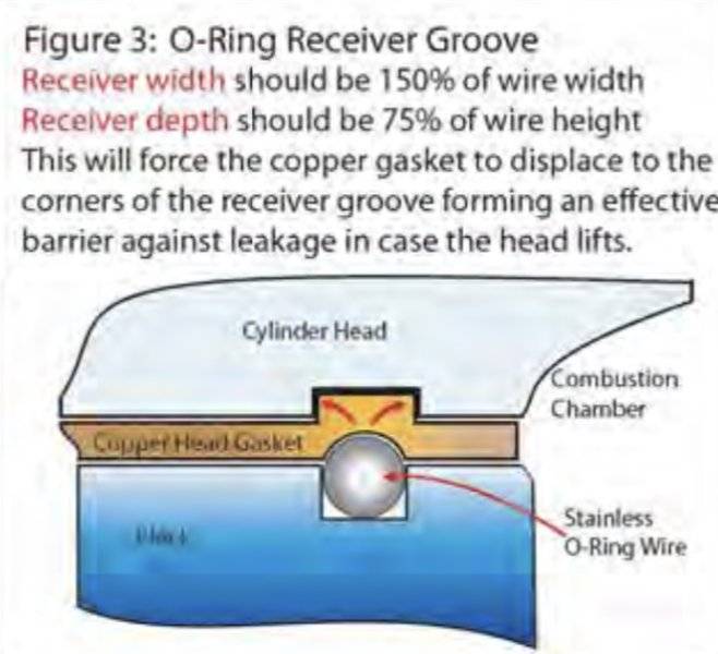

Yes look it over for cracks in main webs, just in case. Looks like block is o-ringed.
Yes, a hemi block.
Sleeved to a much smaller than stock bore, probably to run as a smaller cubic inch motor to fit a cubic inch limited class.
396 cu in, with a stock 426 crank. 6.5 liter, or under 400" class.

O-Ringing provides the ultimate seal on head gaskets. Especially before MLS gaskets were introduced.

No way of knowing without a sonic check. Also depends on the o.d. of the sleeve.
Frankly, the sleeving has damaged the value of the block. Pistons would be a VERY expensive custom set to run it as is, boring out the sleeves is a gamble, and also expensive.
Also,for reference, the row of head bolt bosses inside of the deck, in the valley, is what confirms it as a hemi block. There are kits available to add four bolt mains to regular rb blocks.
Edit: if, IF the sleeves are very thick wall, and IF it was bored over stock to put the sleeves in, you MAY be able to bore the sleeves out to 4.25 without getting into the original cylinder walls. Again, NO way to know what's there without the sonic check.

Why O ringed? What purpose? Thanks.
High horse engines to seal cylinders better. Should've looked closer, didn't expect sleeves. With the price of block all kinds of thing are around.

I would want that pressure tested besides magged then figure out cost to machine and build. Otherwise an expensive anchor unless you want to try to make a small block hemi.

So what he is saying is that, in the eighties, this block was intended to run in a Mopar prostock effort. Before the 500 inch limit, prostock was a weight per cu in class. The idea here was to build a small cu in hemi, to run a lighter weight car. It makes sense.
However! That doesn't add 10 cents to the value of the block, and the sleeves ruin it, in my opinion.
IF it's not a scam, and IF you want it, I'd offer the 2500 for the block, AND heads. A $2000 set of pistons would be a negotiating point.
Then I'd put a 4.25 stroker crank in it for 448 inches, virtually the same bore/stroke as a 455 Olds. High dollar custom pistons either way. It would need a lot less dome with the stroker crank, might even make the pistons cheaper.

Not worth effing with it IMO. Think how that narrow bore is going to work with valves that open near the edge of 4.25 bore. Just spend a bit more and get a normal block that doesn't require custom parts. The Pro Stockers used destrokers not small pistons, just wouldn't make any sense.
