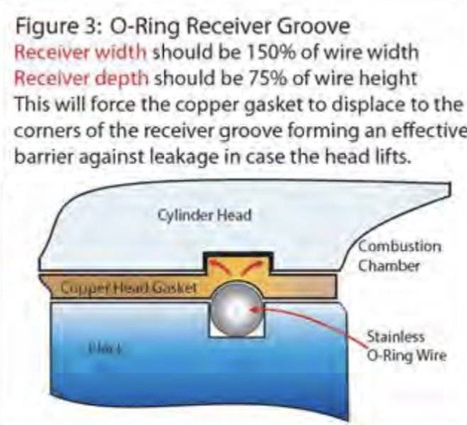

Is this a hemi block?
Isn't o ringing done on supercharged, or turbo engines, no?
Yes, and with Nitrous Oxide as all of these will increase cylinder pressure.
I run O-Ringed heads with receiver grooves cut in the block and SCE Copper HeadGaskets on a blown Mopar SB with Nitrous. This was the only way to hold a head gasket together 30 years ago on a SB. Gasket technology has came a long way since then.
The block appears to be relieved and deshrouded for the intake valve.
