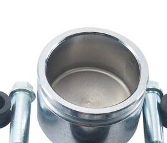

I don't believe the clips will go into that type of piston set up. The clips are for plain, hollow pistons, from what I know.
This is the type of piston I'm referring to:
Not sure, this is new stuff. I was referring to older OEM parts. I would have to see how it all installs to determine the setup. The clip might go into the narrow slot at 6 O'clock in your pic to prevent the piston from turning affecting adjustment. The circular clip might just be to keep the seal on the piston??
Well, the pads fit the caliper and look like what I've seen in various YouTube videos about this conversion. The only thing different is the anti-rattle clip. It does look like it's designed for the hollow cylinder. RockAuto may have had the wrong part listed. Maybe I should cut the clip off?
