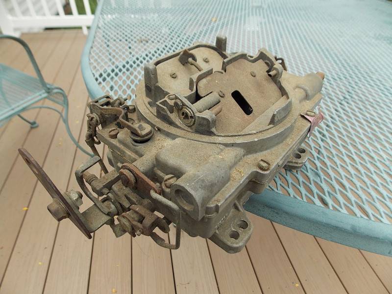

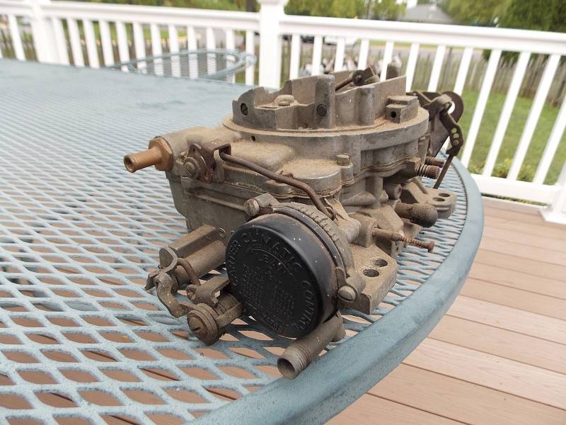

Ok, I had an old 69 440 avs rebuilt and the mechanic said it wasn't possible to change it from a mechanical choke to electric choke. It currently has no choke. He said there's parts missing and it wont work, so he wired it open. One thing he told me was that he used afb metering rods. The originals were damaged. So I was looking for a parts carb and came across this on ebay:
http://www.ebay.com/itm/carter-AVS-...t=Vintage_Car_Truck_Parts_Accessories&vxp=mtr
We use to change them from "automatic" choke to a manual. That is using a cable that ran into the inside of the vehicle from the choke mechanism. It was an aftermarket kit that replaced the spring loaded unit with a leaver that the cable attached to. The one that you are showing from EBay has an automatic choke. Heat from the exhaust manifold heats the spring inside the adjustable housing and opens the choke as the engine warms up. There is a electric choke housing that looks just like the one in the pic but there is a connector for a wire. (newer version) They can be adapted but you have to use a wire that has current only when the engine is running. Not just when the ignition is on. It all depends on what you want and yes you do have to have the right parts that was with your original carb. I don't know if the metering rods are interchangable.

As long as you use the flat top covers as opposed to the domed covers, AFB metering rods can be used in a AVS. It also looks like somebody added the choke thermostat from a GM to that carb and modified the throttle lever.
Im not buying that carb. Just raised a question in my mind. "Is it possible to retro fit an electric choke to an old carter avs?" I don't know the differences between the Edlbrock avs's and the carters.

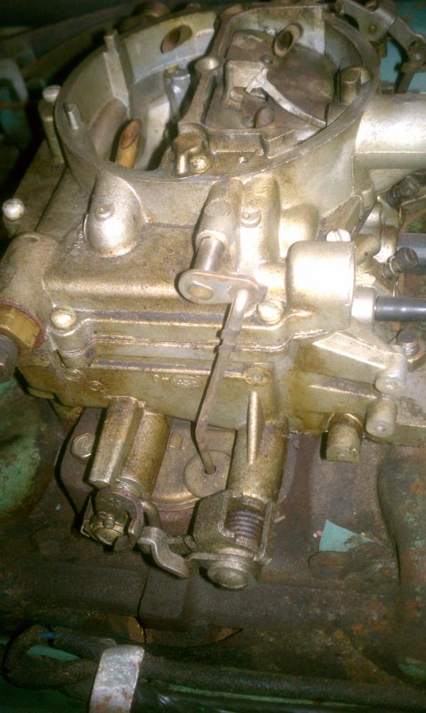

i dont think the old avs carbs have the holes for the electric choke kits to bolt to.look at a pick of an edelbrock carb and you will see the holes i am talking about and then see if your carb has them.(non elec choke carb to see holes)

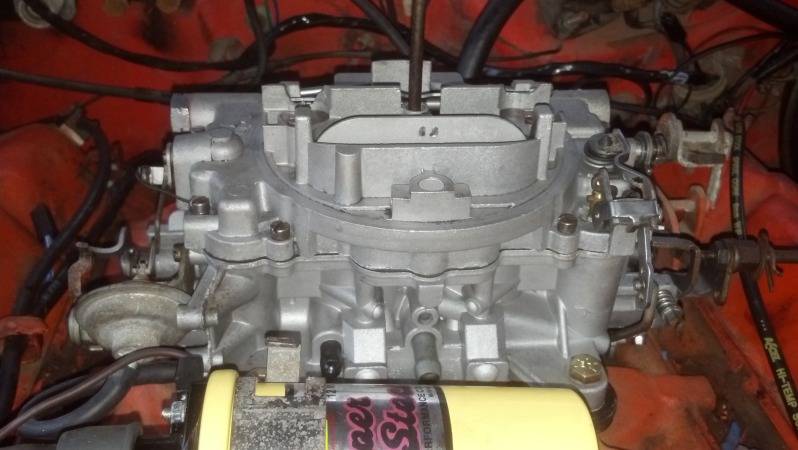

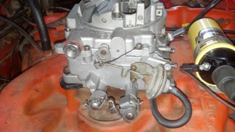

heres what i have
if you look there is a small arm that stick forward just above the choke pull off diaphram.it has a small dimple in it that would need to be one of several holes to mount the elec choke kit.
Your manifold has the indentation for a choke spring assembly as does mine. Follow the linkage from the choke shaft...
