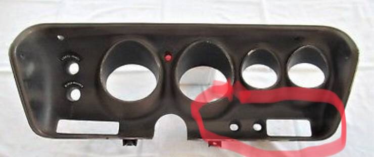

hi , wondered if anyone can help with some info ? Someone’s cut the wood grain insert of the dash on My ‘72 satellite and fitted an aftermarket stereo . Not my cup of tea so it’s now removed, however it now means I’ve a large rectangular hole in the dash .
So , the question is - when the car was built at the factory and the buyer “ ticked the options list “ was there such a thing as “ radio delete “ ? If there WAS then I can fill the hole and repair the dashboard . I could just repair it anyways but I’m intigued to know if there was such a thing as “ radio delete “ like say
“ antenna delete “ when ordering from the factory . The photo shows an original dash , the repair will fill in the highlighted area bottom right .

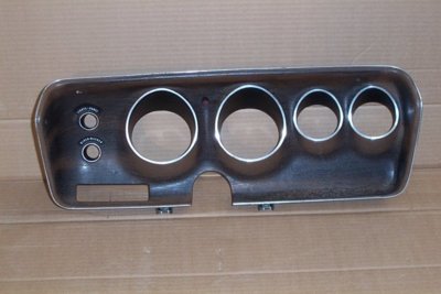

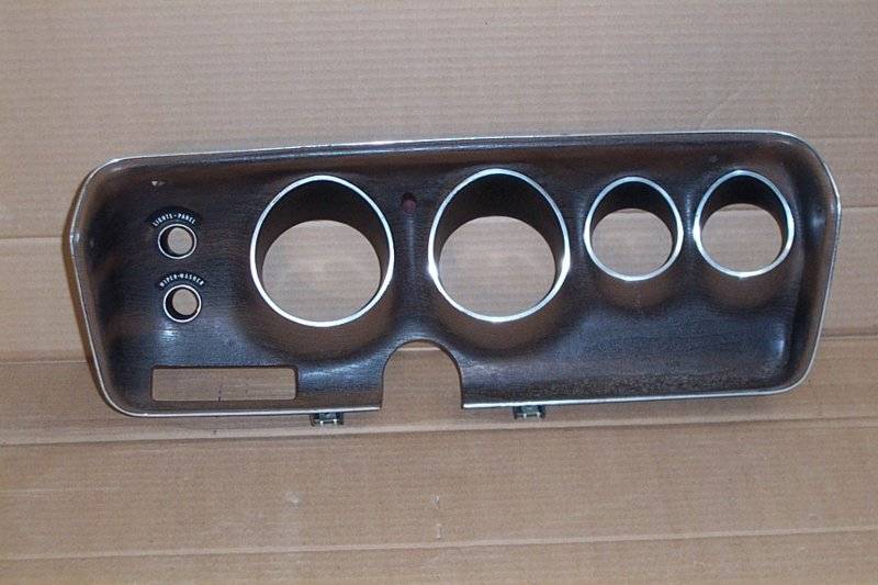

Here is the non radio bezel.
Agree. Something can't be a deleted item if it was never standard equipment to begin with. Radio's were always an option.

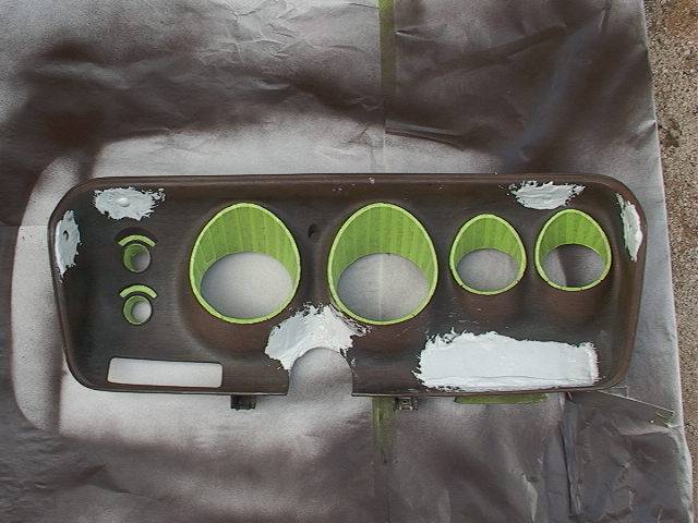

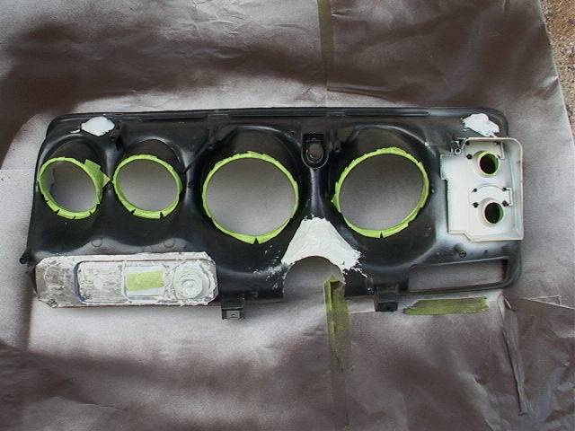

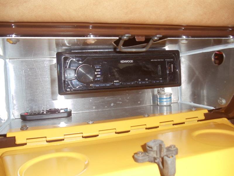

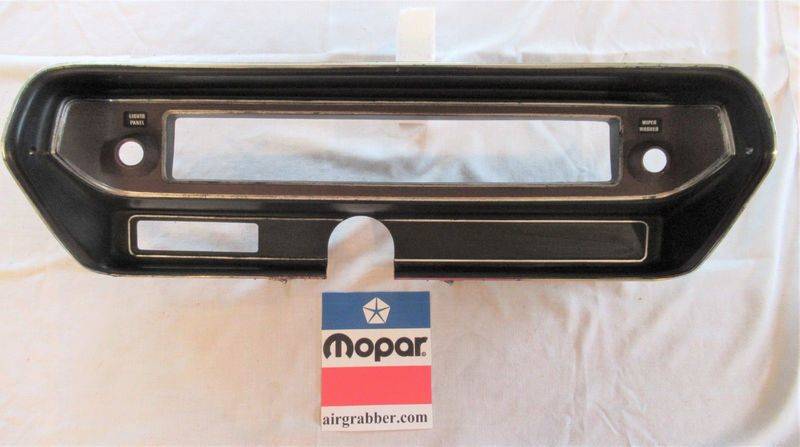

I closed up my butchered radio cut-out using a stainless steel plate secured with a two-part epoxy. Installed a new radio in the glove box (fabricated a stainless steel glove box).

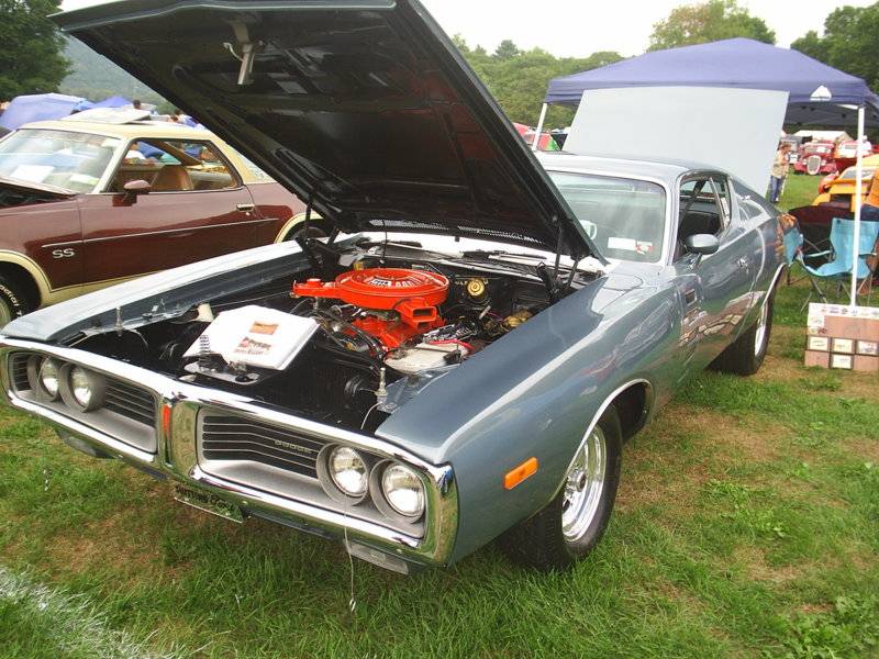

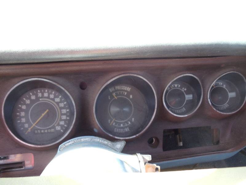

Yes, there is always radio delete ... heater delete too. I've seen them.
The fellow I know has a 72 rallye radio delete.
Zoom into the dash shot.

That’s a really great job you’ve done there mate ... excellent and thank you for sharing it with me ... spot on !

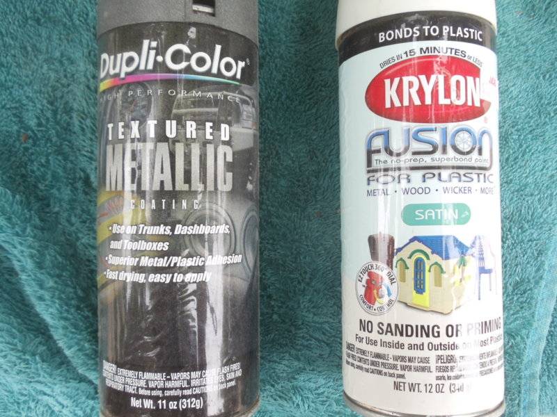

May I ask , what did you paint / cover the newly filled in hole with ? Did you repaint ? Plasticwrap ?
Quote from above: "what did you paint / cover the newly filled in hole with ? Did you repaint ?"
It took several sessions of applying and sanding the two-part epoxy to fill in the hole after inserting the stainless steel rectangular stop-gap piece.
Then I used a white Krylon Fusion plastic paint as a kind of "primer" and top-coated that with Dupli-Color silver textured metallic coating.
I did have a problem, my own fault. Due to my "perfectionist" attitude, I repainted a portion of the bottom bezel with more silver, which later bubbled up some. I should never had applied so many coats. In other words, use the least paint possible when re-finishing plastic pieces.

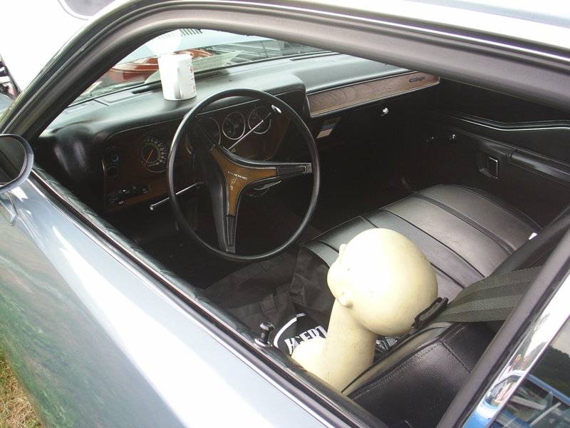

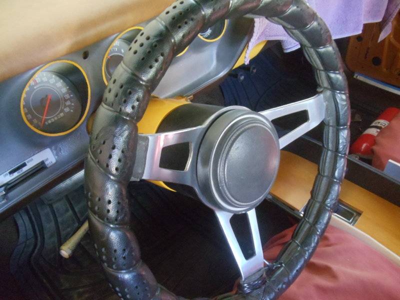

View attachment 691268 View attachment 691269
IF that is true, then it should be relatively easy to post a window sticker showing a delete credit or a broadcast sheet showing the delete. As it affected the BIW, you should also see a radio delete code on a fender tag. The information that deleting a radio was possible and the associated credit would also appear in order guides or salesman info. Please provide one of these pieces of evidence supporting your position of “radio delete”, the coding and credit.
You can order a car without a radio, but you CANNOT delete something that isn’t standard.
It was possible to delete a heater in certain circumstances. That info can be established.
