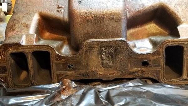

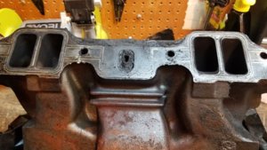

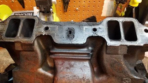

So I finally found my answer to the carburetor problem I know we discussed every thing under the sun but here is the culprit .

Make sure the exhaust heat raiser valve is not frozen shut. The carbon in the crossover might affect a manifold mounted choke, but might be a result of a problem, and not the cause of the problem? Hopefully the piston rings do not have that much carbon build-up.

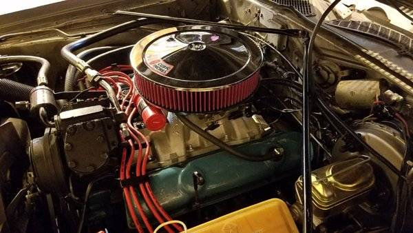

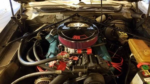

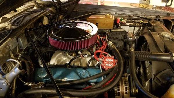

I went with a whole different set up Edelbrock Performer Manifold and Edelbrock 600cfm carburetor new fuel tank , fuel lines, fuel pump. MSD distributor, coil, wires. A whole different car now.
I got rid of all that and went to headers which looking back was why this happened the EGR valve was completely plugged up with carbon and at one time i put a plug on that which I'm sure was also the cause of it all. Plus I found out why my rpm's at idle were always changing the choke would stay open just enough to cause it to do this.
Sounds like it runs much better now.
My first car had a 318 with really bad carbon build-up. The piston rings were frozen to the pistons with carbon it was so bad.
Ya night and day different should of done this a long time ago instead pulling my hair out lol.
