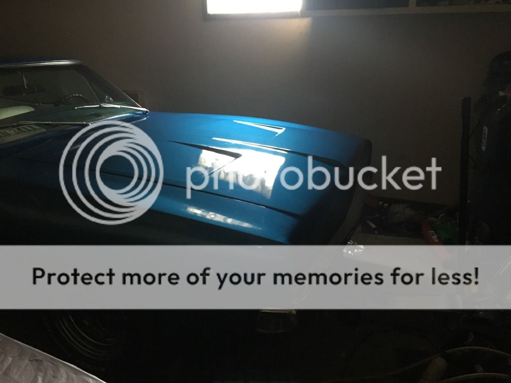

This weekend I managed to sneak out between the rain storms and give the car a proper wash and wax. The sky darkened up pretty quick, so I pulled it in before I got to the glass, chrome, and wheels. But this is the first time in a few years that it's had a shine on it, instead of just a bunch of dust. Even if it is just in the garage.

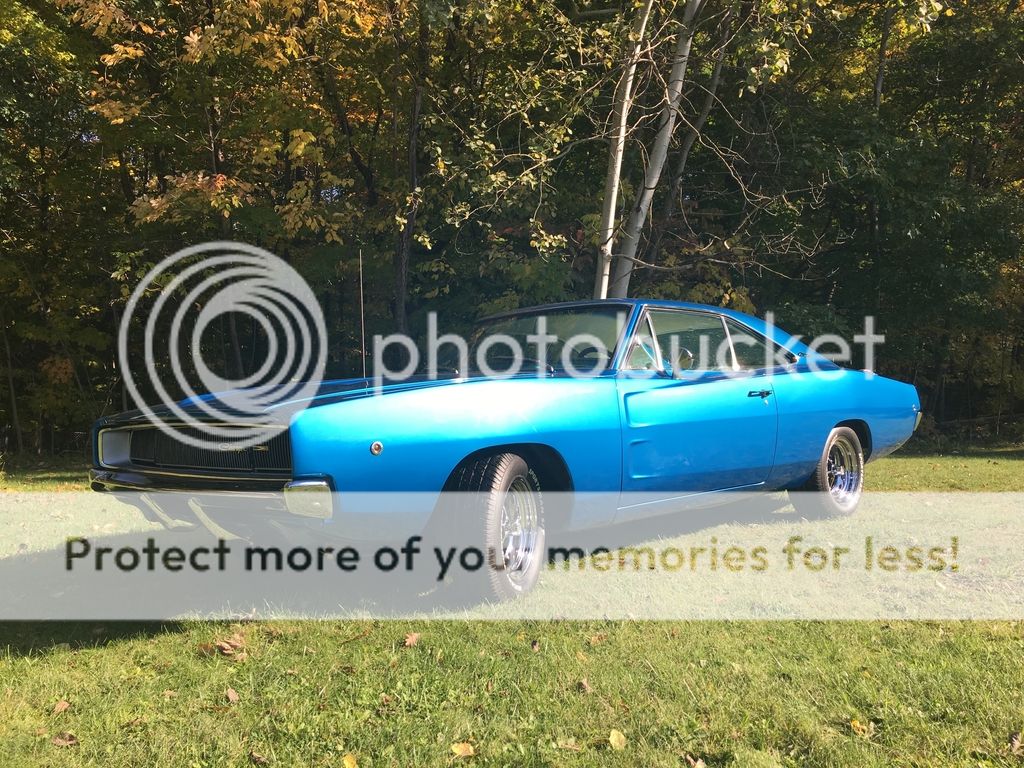

Took some fall photos of both cars:

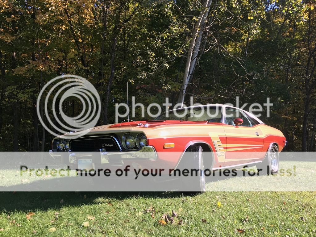

Challenger

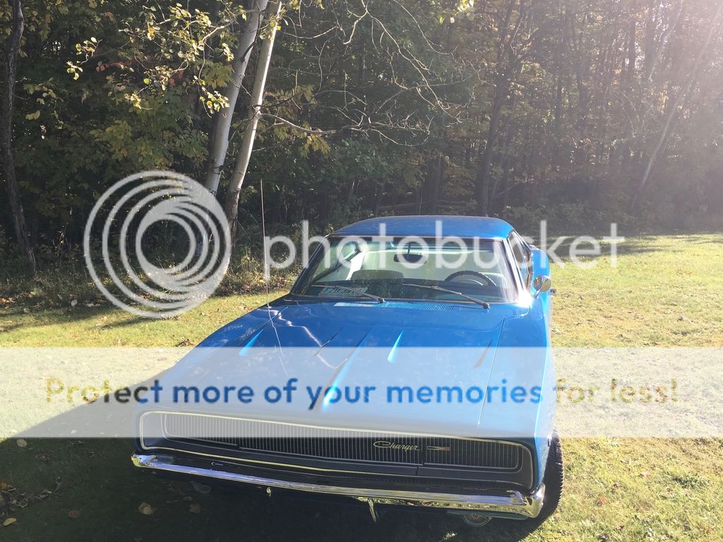

And the Charger
