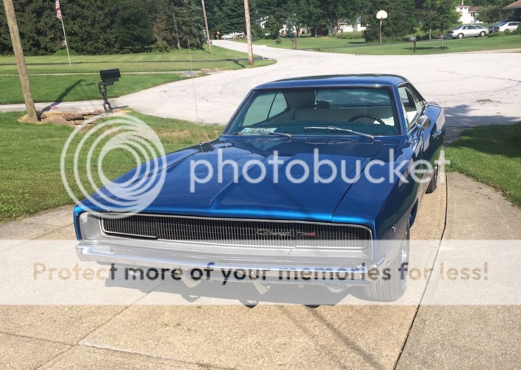

JamieZ's 68 Charger
Warmed up and dried out so.....
Well it mostly dried out......
Anyhow it's back in the garage
It needs a wash and now I can swap in that reverse harness I had sitting around all winter. The fun begins again!

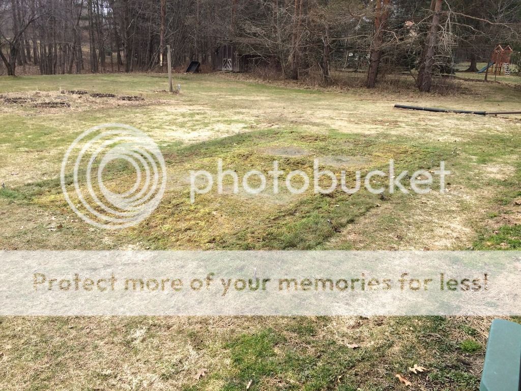

Took down the bulk of the shelter today. I left the augers in and didn't move all the plywood but I think I got it down soon enough for the lawn to recover.
