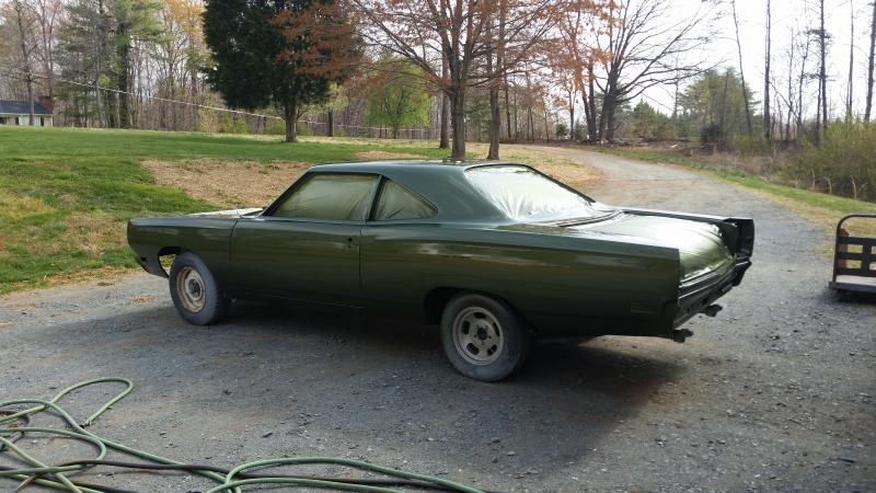

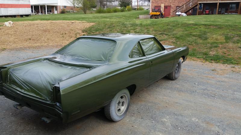

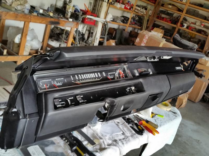

Dash is 90% finished. I also shoved her outside in the sunshine. color sanding this weekend.

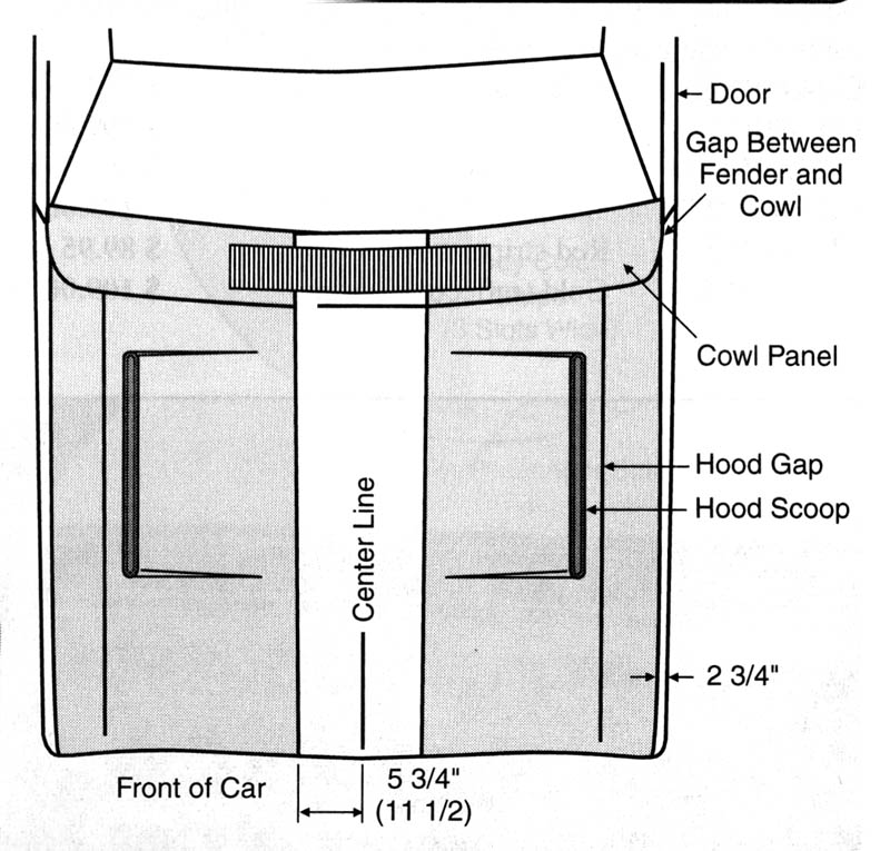

Does anyone have a good drawing of the hood stripes. I know what I have done in the past. but I was wondering if a factory layout existed?

Thanks Hawk. The rr emblems were the teaser that I sent to Jeff . smart phones rule . and I agree with you about the turn of the corner thing. I hope that the rest of the car turns out as well as the body. My dad used to say you can't half *** it now.
Sweet job on the dash! Looks new. I'd guess that the magnetism of the upgraded center speaker magnets are pulling that Tach needle over?
If so, I had the same issue when I installed a pair of Polk Audio speakers for the center speaker in my bird. Had to buy a shielding metal called MuMetal to knock the magnetic field down. Can't remember where I bought it from (some audio store online), but I bought a 3" wide x 3/32" thick and about a foot long hunk of it. Cut it to fit and secured it in place next to the tach with a couple hunks of 3M butyl ribbon sealer (didn't want to drill any holes to secure).
thanks a lot Propwash, I have to do something but I hadn't made up my mind on what. do you have any pics of your fix. I like to see other folks remedys for this kind of thing. aircraft folks probably have more experience with this kind of thing.
I'd post of a pic if I had one for you sir. Unfortunately the bird is tucked in a storage shed for about 2 more weeks. Basically you take a couple small pieces of the stuff (cuts easy with a tin snips, bends easy as well), tape them together and secure them next to the side of the tach. Pretty easy to do.

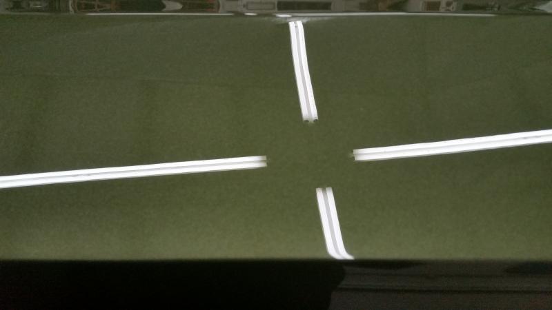

Thanks showard. I am very happy. So I am including a few glamor shots.
