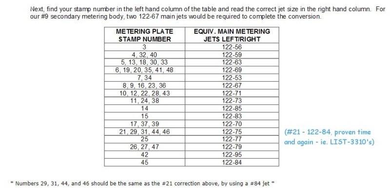

Take a look at this chart. It will show the jet size equivalent to the metering plate.....for the outboard carbs.
I wonder what in the world used a #42 metering plate? (95 jet?!?). The big three barrel maybe ?
My #41 metering plates are not the same size on both sides. These are from my small block stroker, originally a 340. Seems like they wanted the left side richer than the right.
