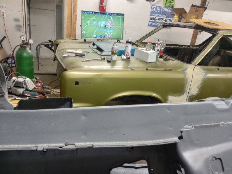

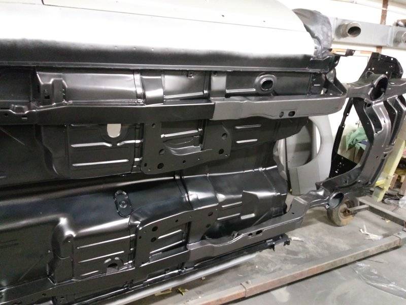

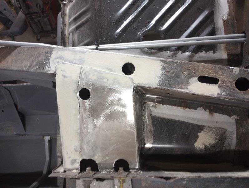

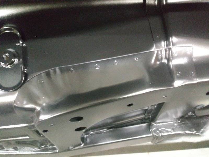

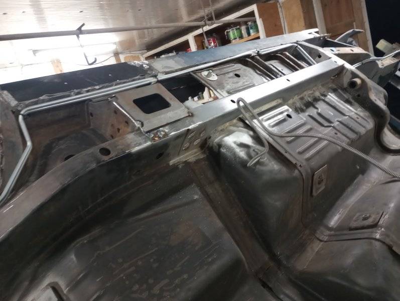

plowing ahead......rear torque boxes fitted, not welding them in until I blast that area....... front boxes in, one side was kinda smashed in that area, not any more......... all while watching football

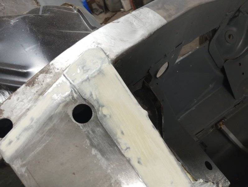

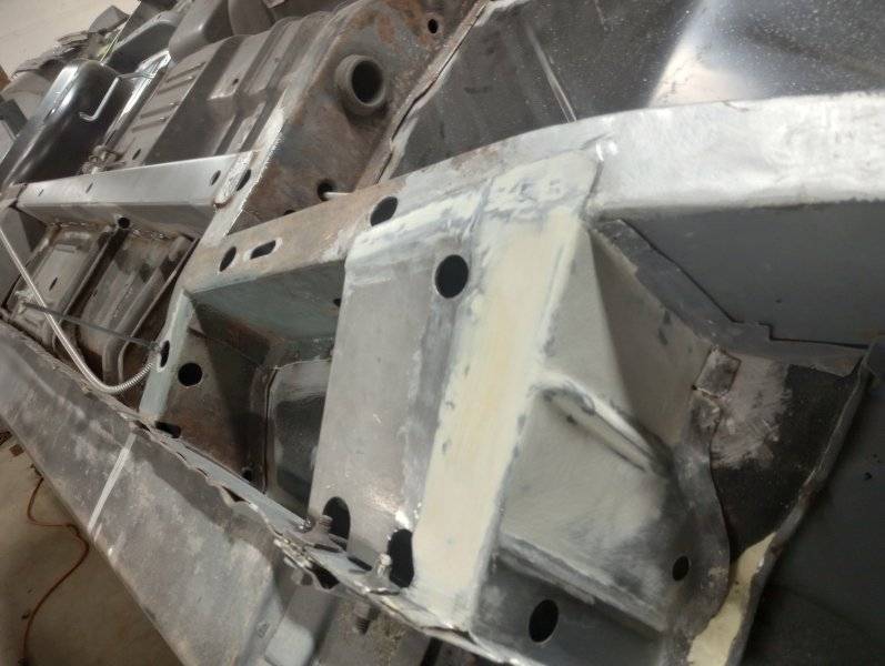

I don't know how much difference it makes but I made my front torque boxes longer:
I made those from 14 gauge sheet metal. I just figured that going to the torsion bar crossmember might be more rigid.
I'm not sure if that area even sees any stress; if it does, I suppose anything helps........ in this case, that factory piece was smashed pretty good and the torque box really helped with the fix. I may have replaced the piece if not for the box........
unrelated to the point, I also try to mimmick factory assembly methods where I can; I try to keep all the mounting tabs and edges clean, rather than run beads of weld around everything
I can see the appeal of the factory appearance. Some really want that.
I’ll never see 200 mph on a NASCAR track with any of my cars. I just figured I’d run my torque boxes to what made sense to me. Those rear boxes you have there look cleaner than my hand made ones.
Who is going to see them? Are they doing their job? FUNCTION OVER "PURTY"

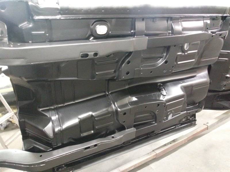

eldubb did ragtop Camaro, undercarriage braces etc... TOTAL MASTERPIECE, shame no one will see it, the guy that owns the car needs to put it on ramps with mirrors to show the work Mark did, which is over engineered too.
when it looks like ****, EVERYONE sees it; if there is never a mention of it, it must be good.......... I'm into form AND function

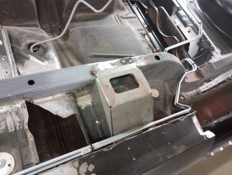

but I managed to get the other front box finished up last night
