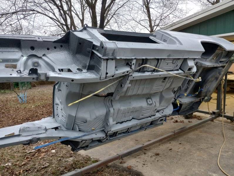

My place is full of trees.....live oaks don't shed until spring time and there's several in my yard along with the oaks that shed in the fall. And with the dry summers lately, they all lose leaves. I'm always blowing out the shop but not so much this year. RPITAgreat pics ^^^^^^^^

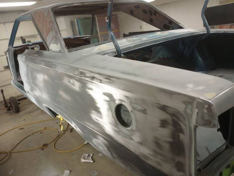

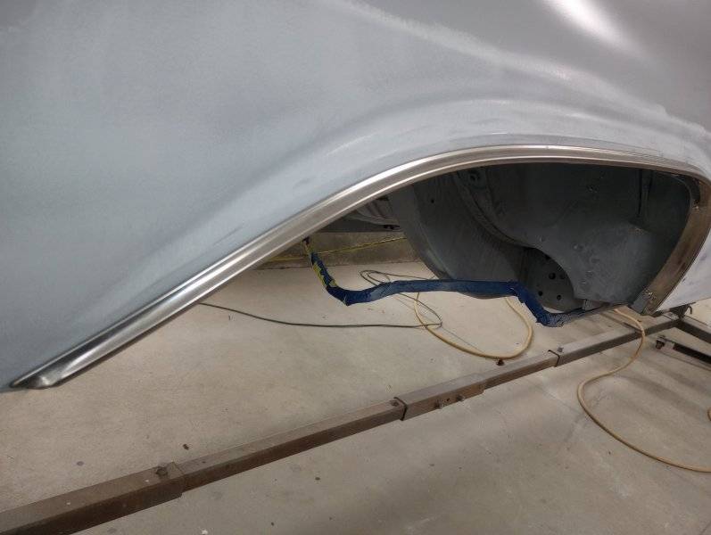

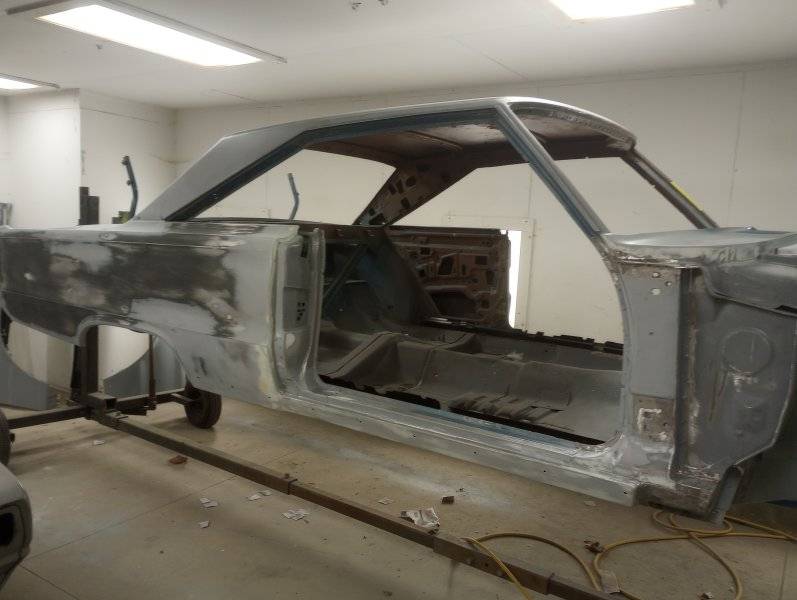

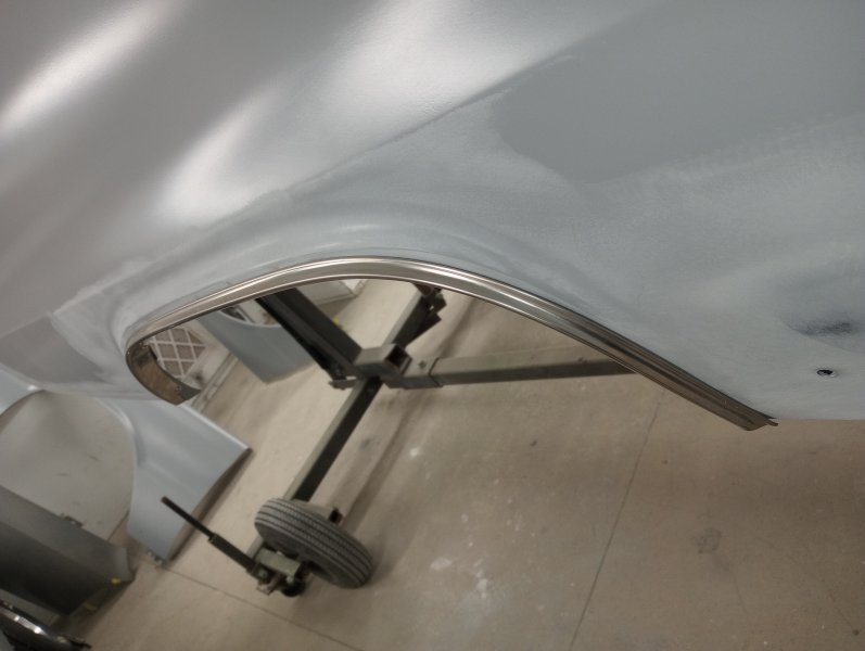

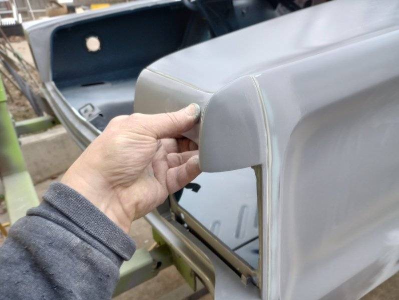

@HawkRod ......... look at the right fender in that picture, you can see the bottom "kicked out" behind the tire plain as day...... remember the issue we had with that? it was manufactured that way, it even stressed the rocker trim a bit.......... you can shim it out, but you can't shim it in
I've seen that lots of times too....my 66 looks pretty straight though. Trim that isn't straight or even looks like crap to me....tiny little dent where the bumper contacted, pinky size......... no way it twisted that fender. I'm going with factory defect, cause I've seen it before
either way, it's fixed now![]()
Or went out for a toke or two on the wacky weed....The way my buddy explained it on my car was the rocker was assembled too far in ( as I recall)
Same side. Also on that car , the DS quarter was sticking out by 1/2 ". There was that much lead filling the trunk gap. The trunk drop offs were barely welded in.
Someone had to go take a **** or something while putting my car together![]()

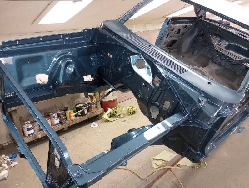

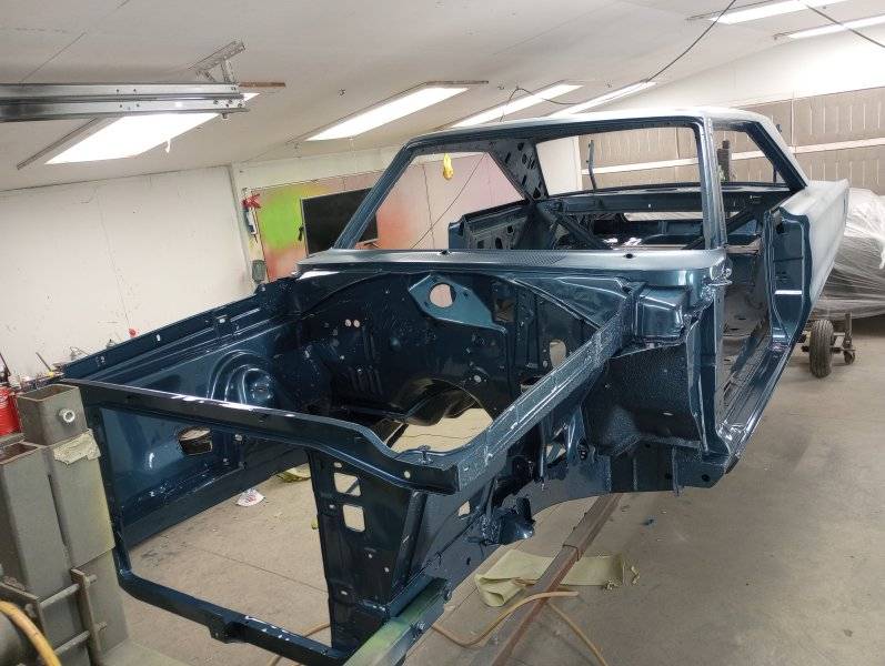

It's time to don the suit, crank up GNR, and start spraying!

Are you going to spray some blue before you go on medicare?the list is shrinking, I swear it is

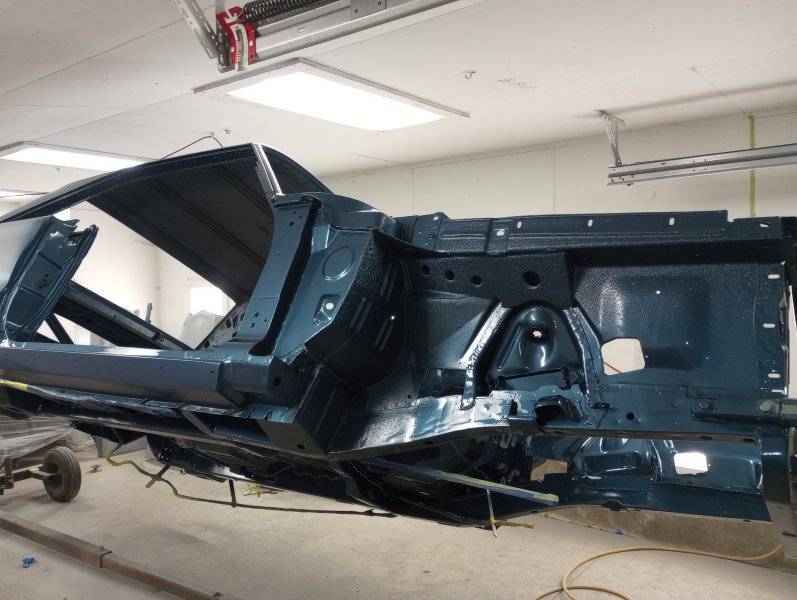

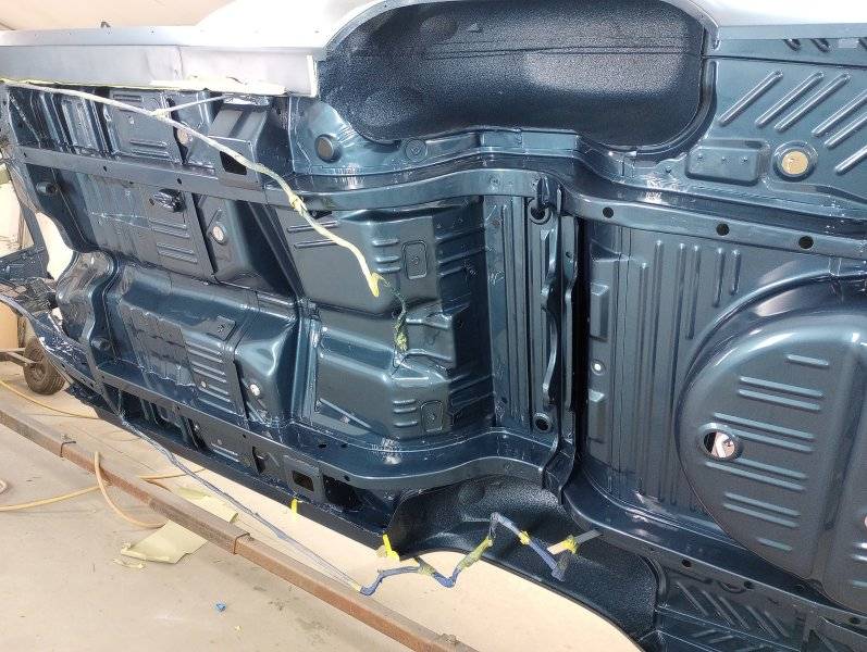

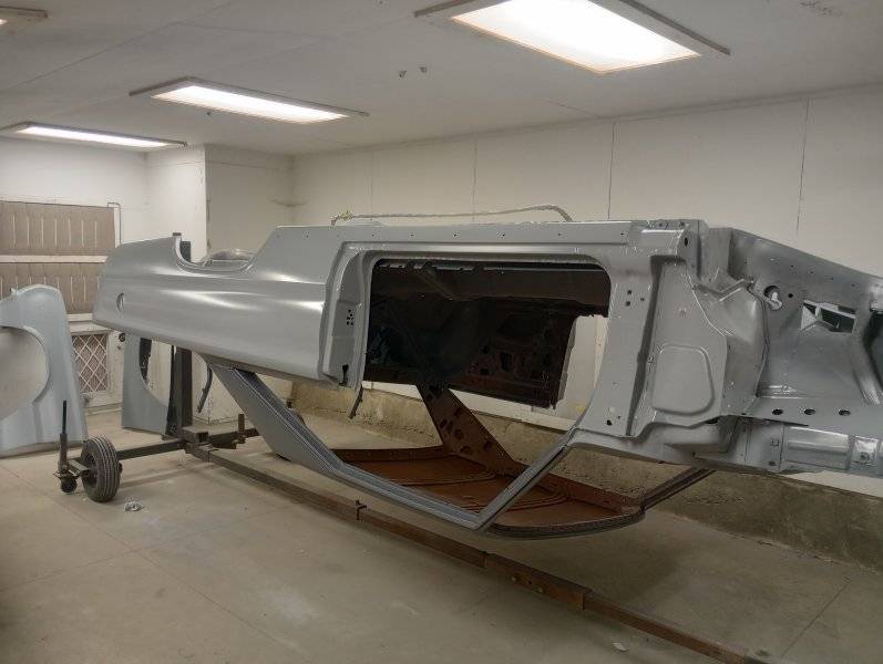

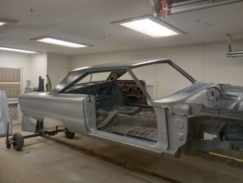

rear wheel opening moldings mocked up

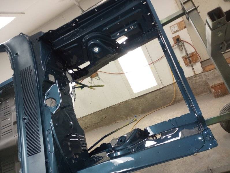

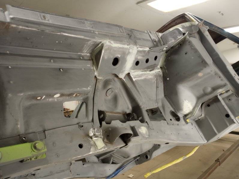

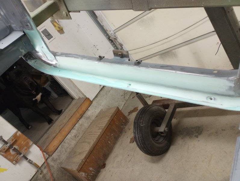

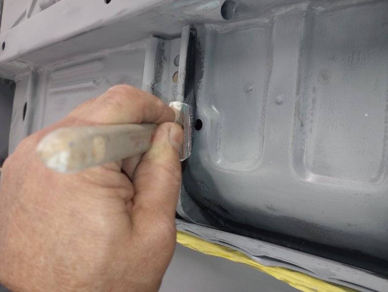

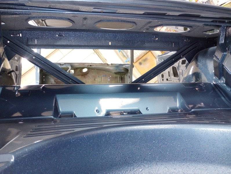

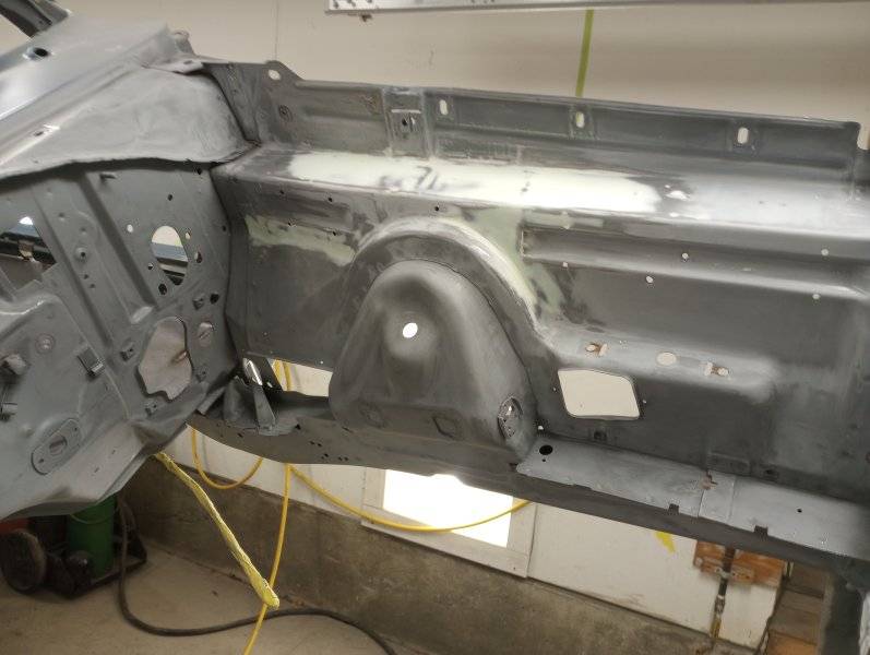

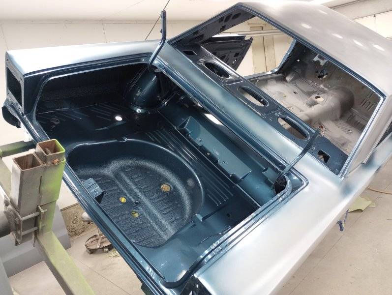

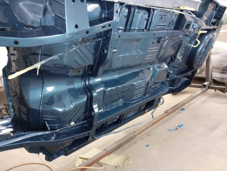

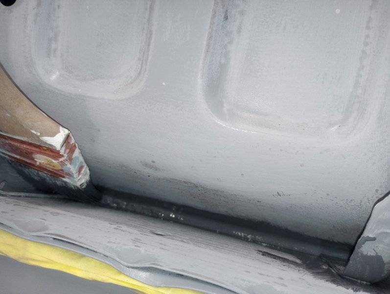

I puddled epoxy primer in to the hard to reach areas, and any of the seams that were undisturbed......

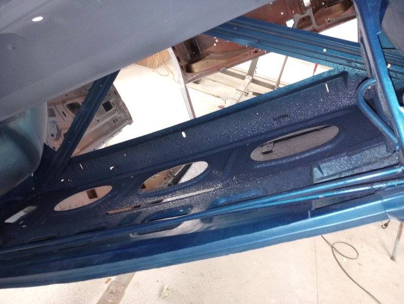

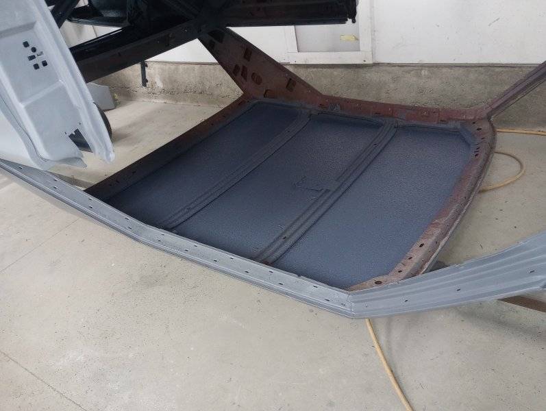

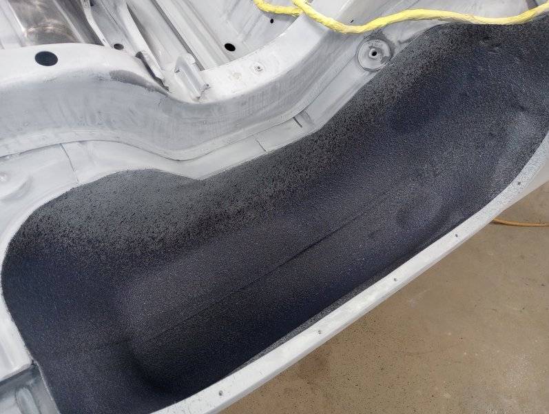

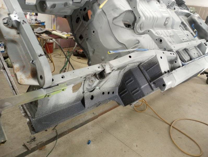

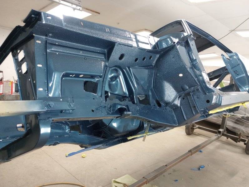

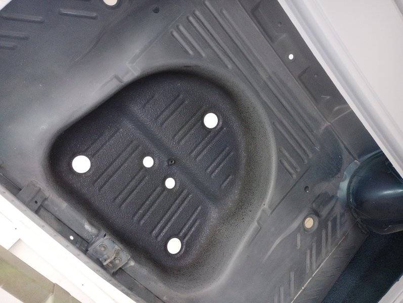

sound deadener under the roof and package tray....... we call it rock guard when used in the wheel wells and fenders....... I don't know what to call it when used as a cushion for the spare tire
View attachment 1581206View attachment 1581207
View attachment 1581212View attachment 1581210View attachment 1581211View attachment 1581209
View attachment 1581213View attachment 1581220

Looks really good!

That looks amazing eldubb440! Another two years and I'll be ready to paintSay, what did you use for sound deadener and why those spots (and not other places)? Terry
