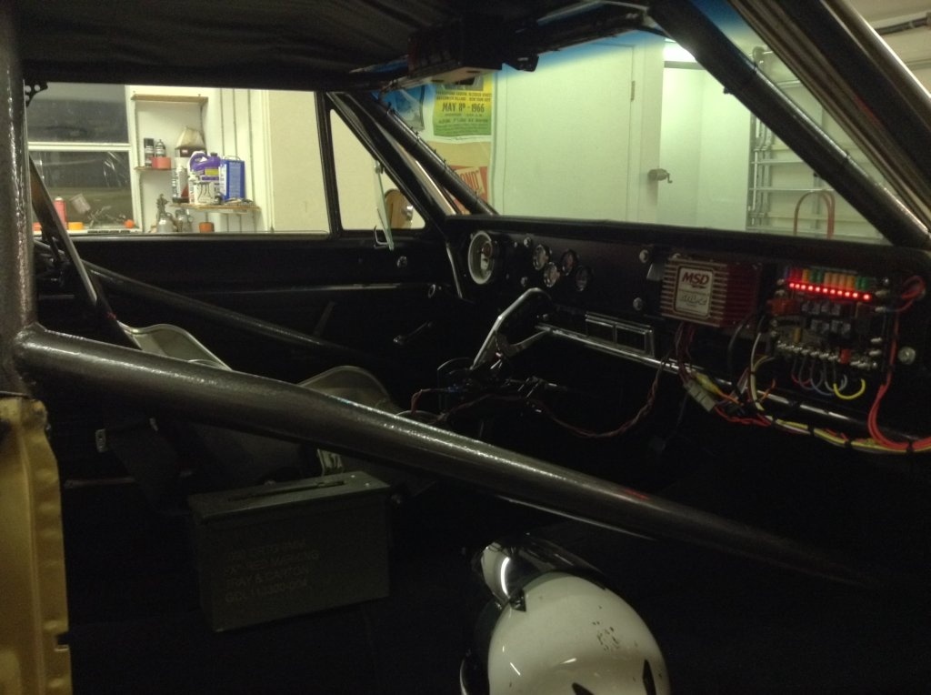

Also I am doing a little write up about my wiring in the car. I know Mike is interested in some pictures and info on that.

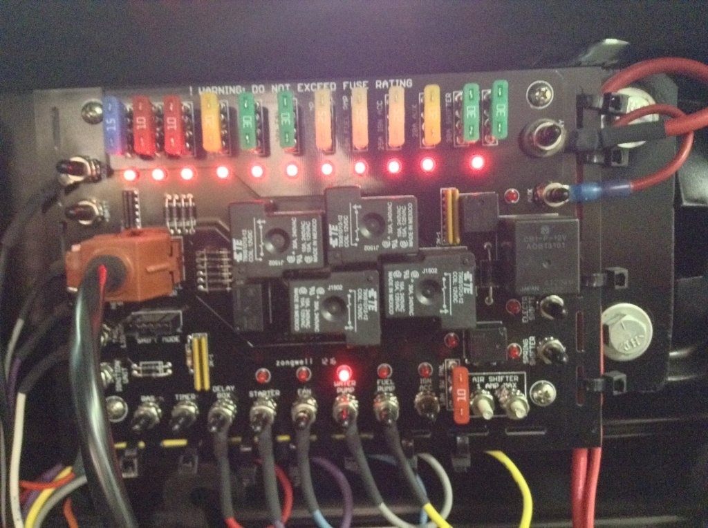

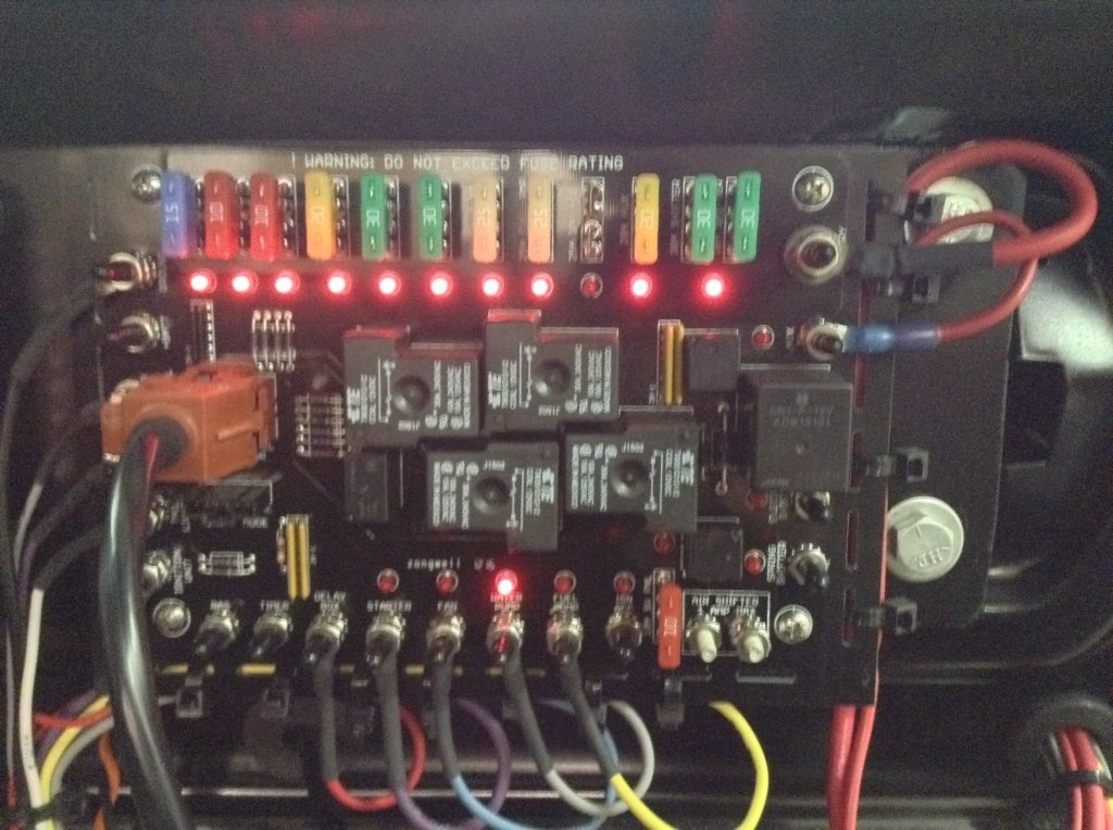

When I was looking for kits to wire up my car I turned to my buddy Mike who has also used this kit without any issues. This kit is made from K+R Performance, the "Super Duty" kit. Comes with all the wiring you need plus a huge laminated diagram on how to wire your car based off different ignition boxes, if your using a delay box etc. Diagram is extremely helpful as well as the staff at K+R. They have asked not to post their diagram as they do not want people copying off it. I did have an issue with my original switch panel, called them up and they had another one on the way same day. Awesome company to work with, I would recommend them to anyone.

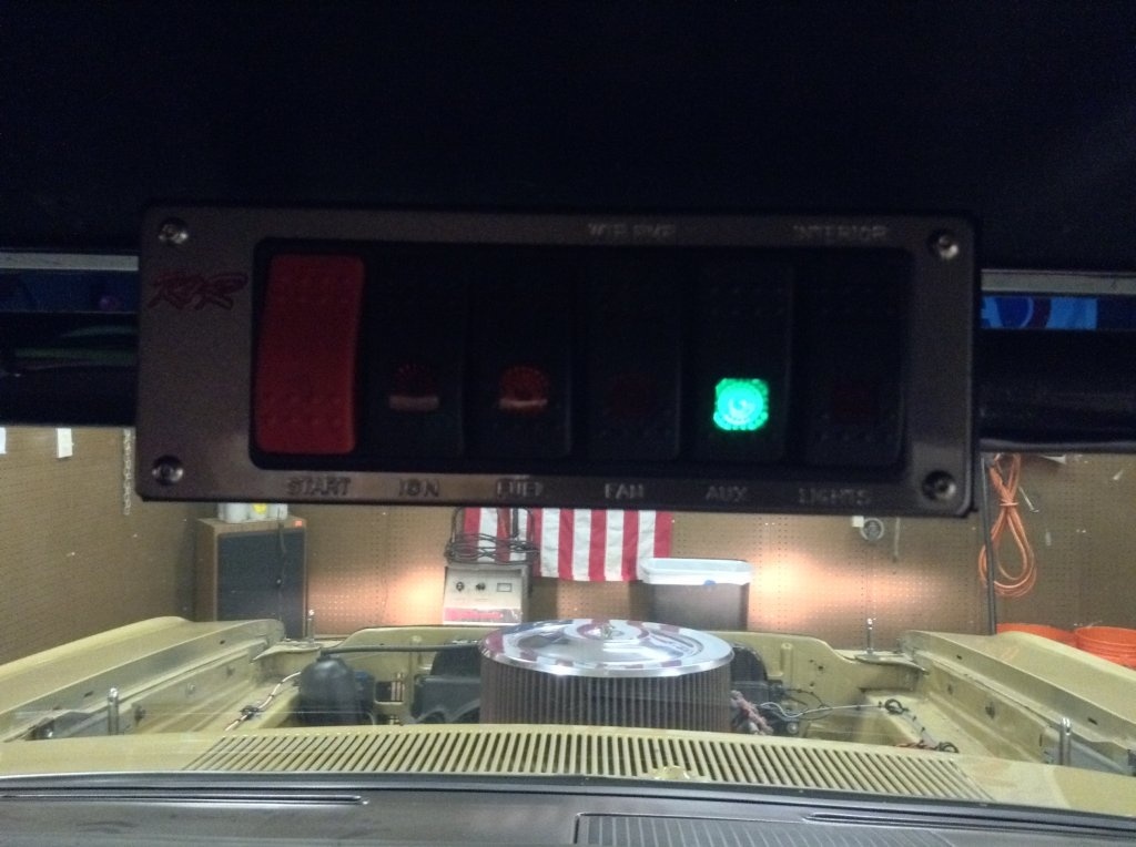

Now everything is centered around the circuit board that has fuses as well as LED's built into every circuit which then go to the posts that you hook the wires up to the appropriate function (Water Pump, Fuel Pump, etc) One of the cool features (As pictured) is that if you have a fuse go out, just glance at the board and look for an LED that isn't on. If the LED above that fuse is out, then its the fuse. Easy to identify since we all know electrical problems will drive you nuts. A few other things to note is that their is a AUX circuit that you can use for whatever. I use mine for the headlights. Another thing to note is the INT light button, I have mine wired up to my dome light as well as little LED's that are built into the bottom of the switch board. Last thing I loved about it is that the neutral safety switch is built into part of the board. Make it much easier to wire up in my opinion.

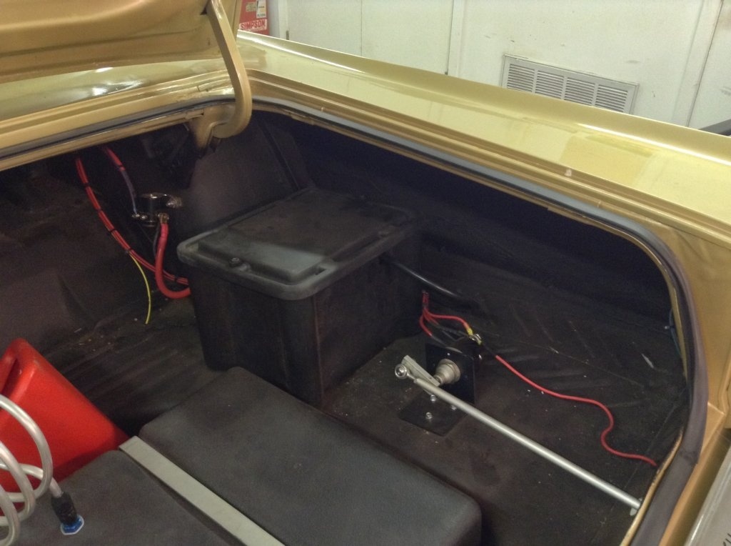

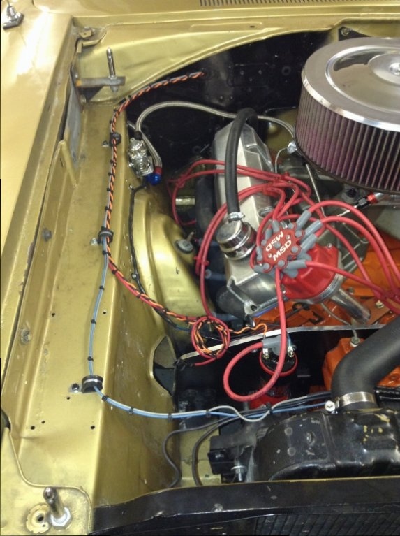

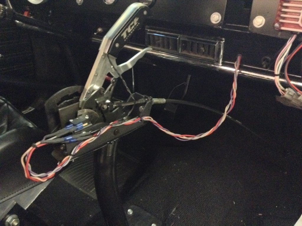

This kit by K+R is so well done and includes damn near everything you need to wire up your car (Minus the 1-0 gauge wire from the battery in the trunk) Here is a ton of pictures that I took over the car, if you guys have any questions feel free to ask. K+R helped me out a bunch and can't thank them enough.
Now for the MSD box, its a 6AL-2 Programmable Box. Locked out distributor, and now I do all retarding via laptop. You can program Trans Brake RPM, Burnout RPM, and Rev Limiter. You can also map out your own timing. Say distributor is locked at 35 degrees. I can set it as retarded as I would like and the box will automatically retard timing based off what I set it at. At start up I have it set to 15 degrees at RPM under 500 to aid in starting 11-1 505, I have had no issues since doing this. There are more features built into the box, but I haven't used it/ had no need to. Awesome box, a bit on the expensive side though.
If you guys have any questions about anything feel free to message me or else post on here.
