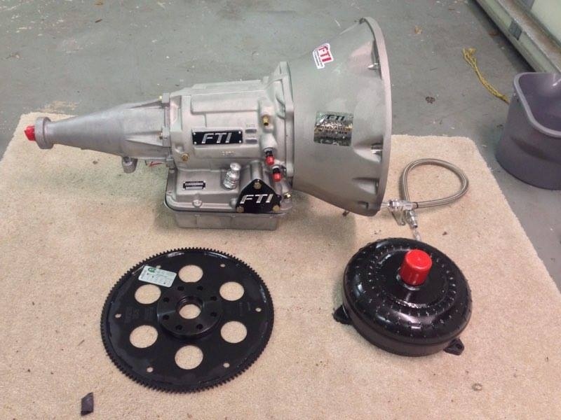

Sorry guys, I appreciate all your input. When I ordered this thing I must of talked to FTI Performance for about an hour just going back n forth about all the concerns I had. All n all they assured me that for bracket racing, its the place to be.
Sorry guys, I appreciate all your input. When I ordered this thing I must of talked to FTI Performance for about an hour just going back n forth about all the concerns I had. All n all they assured me that for bracket racing, its the place to be.View attachment 380285

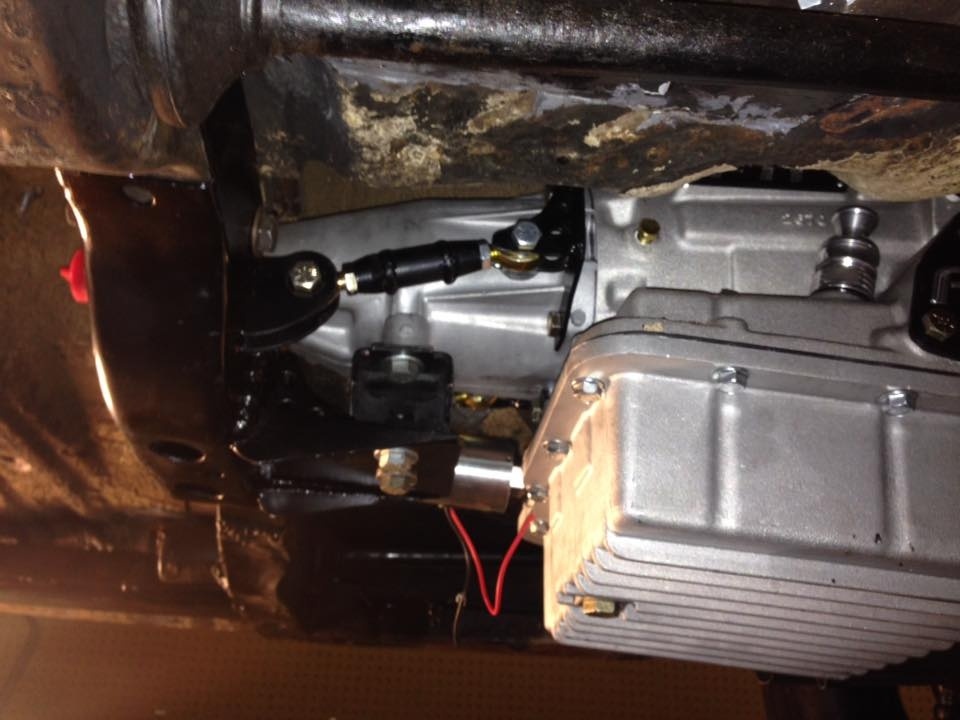

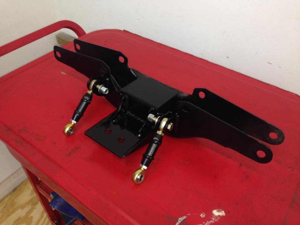

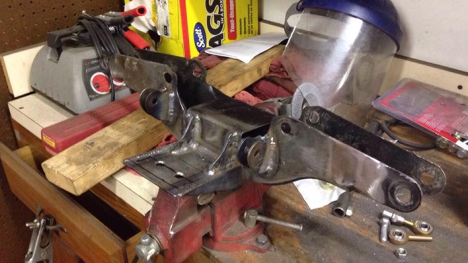

Got the engine and trans in yesterday. Had to do some fab to get the mount to work, plus had to make some fore/aft mounts. Went better then expected.
